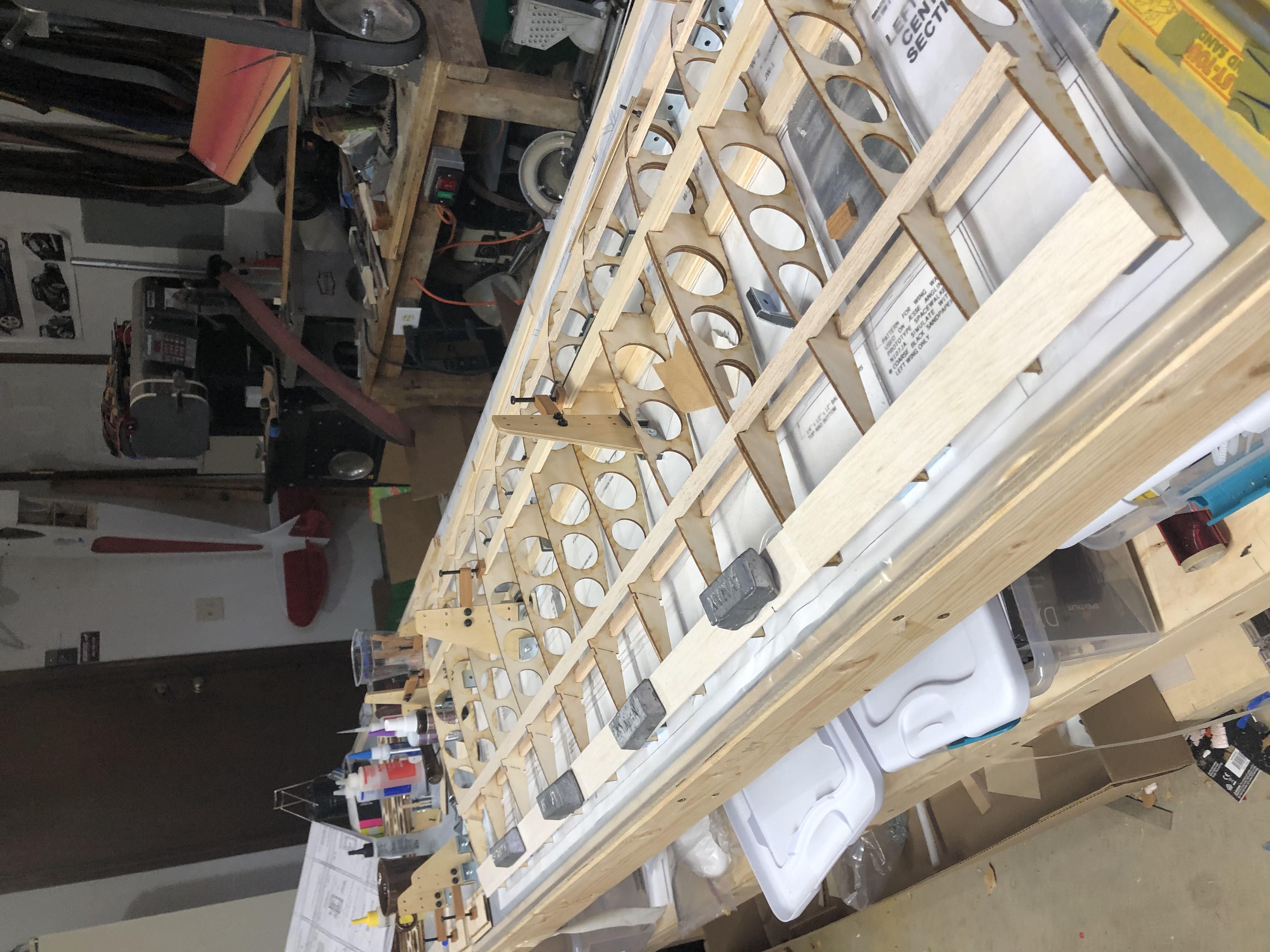

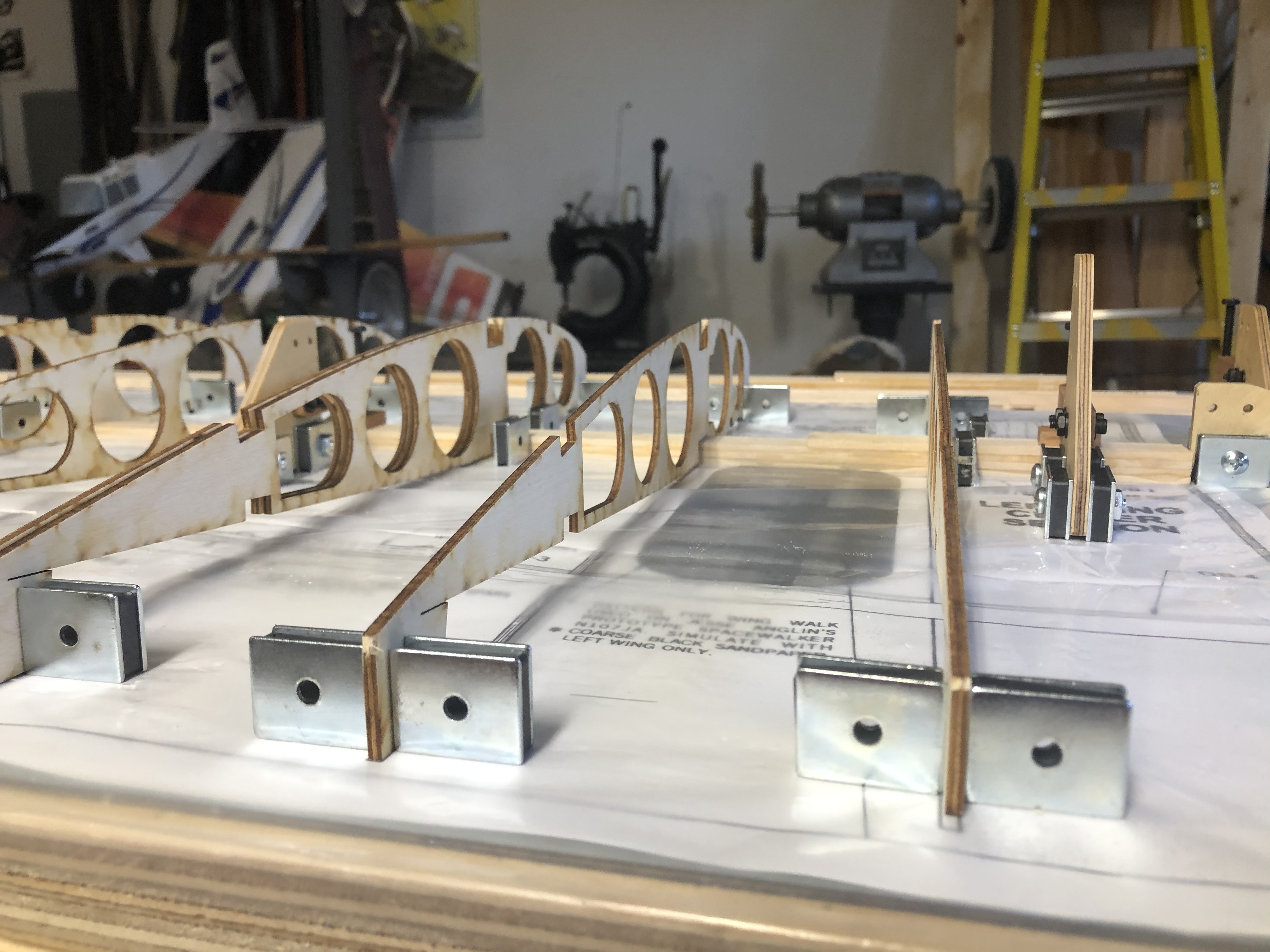

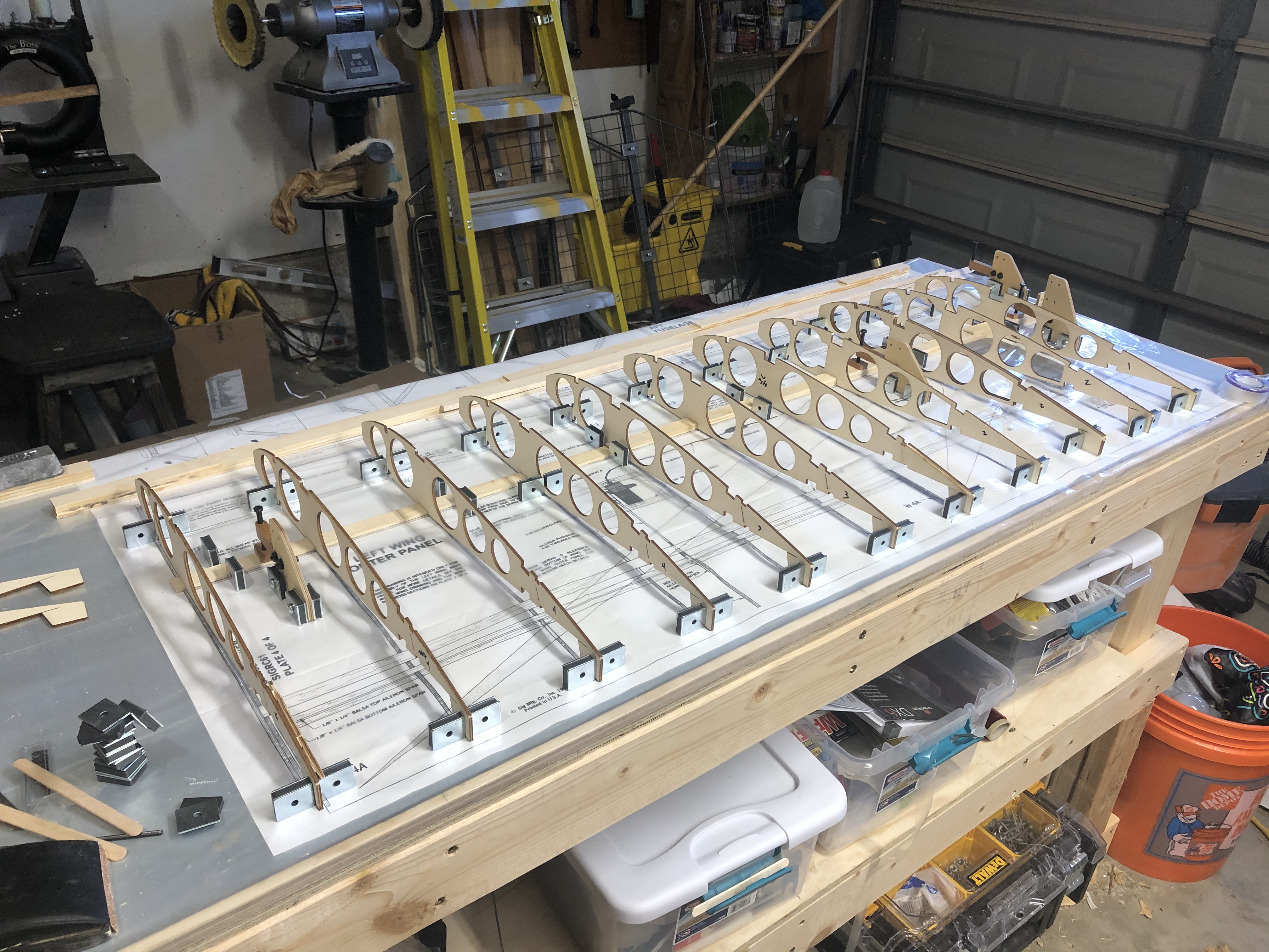

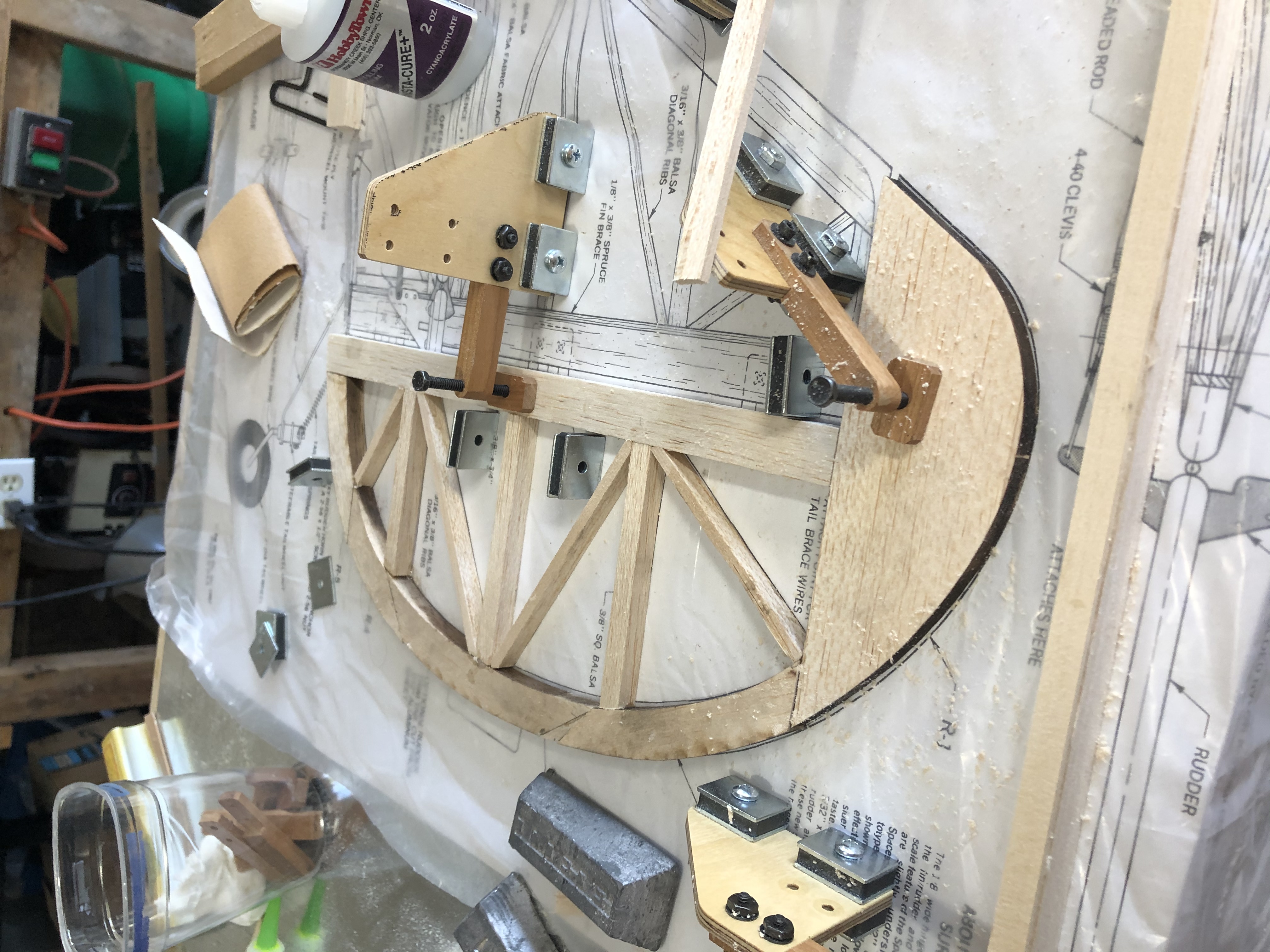

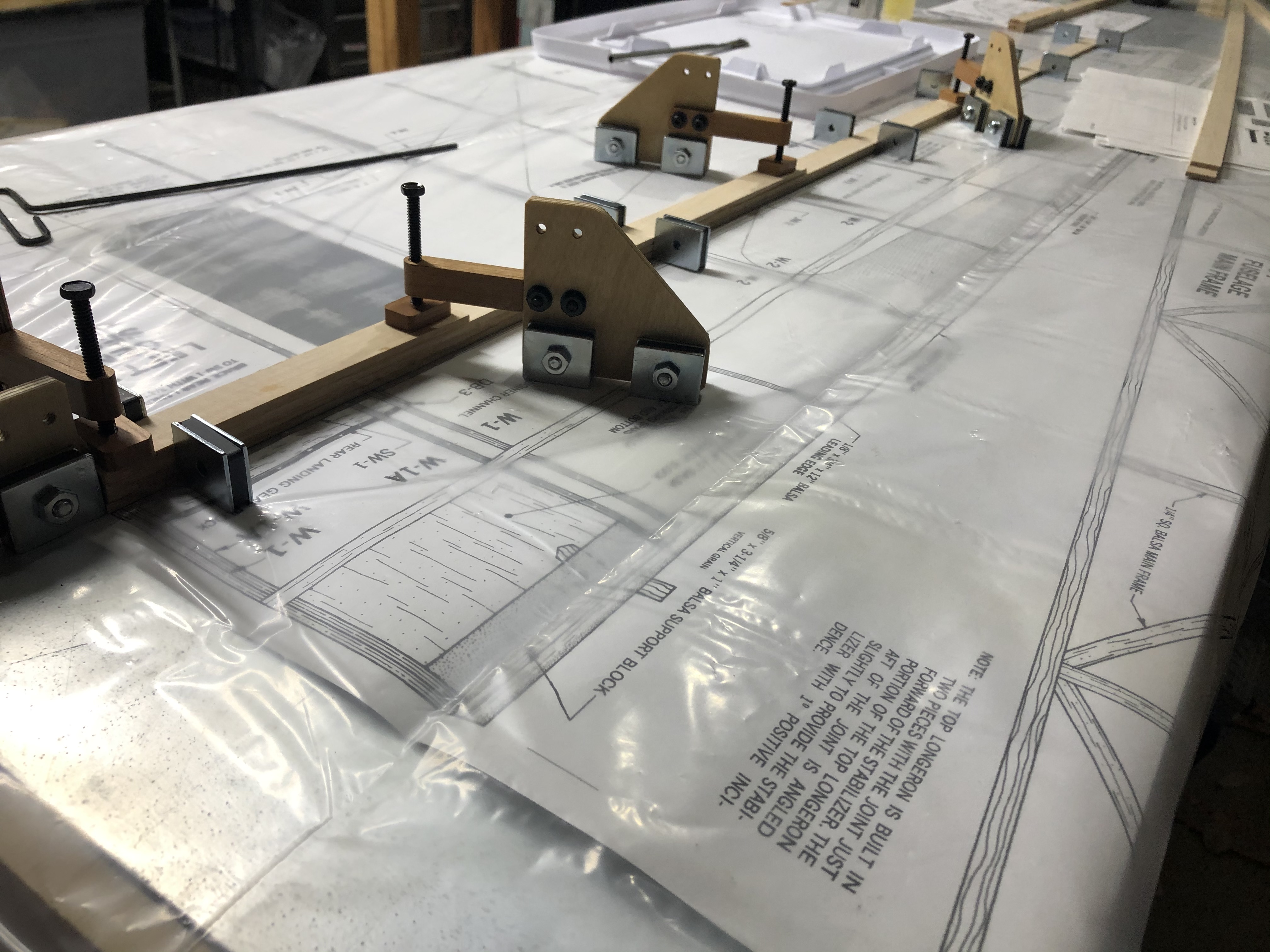

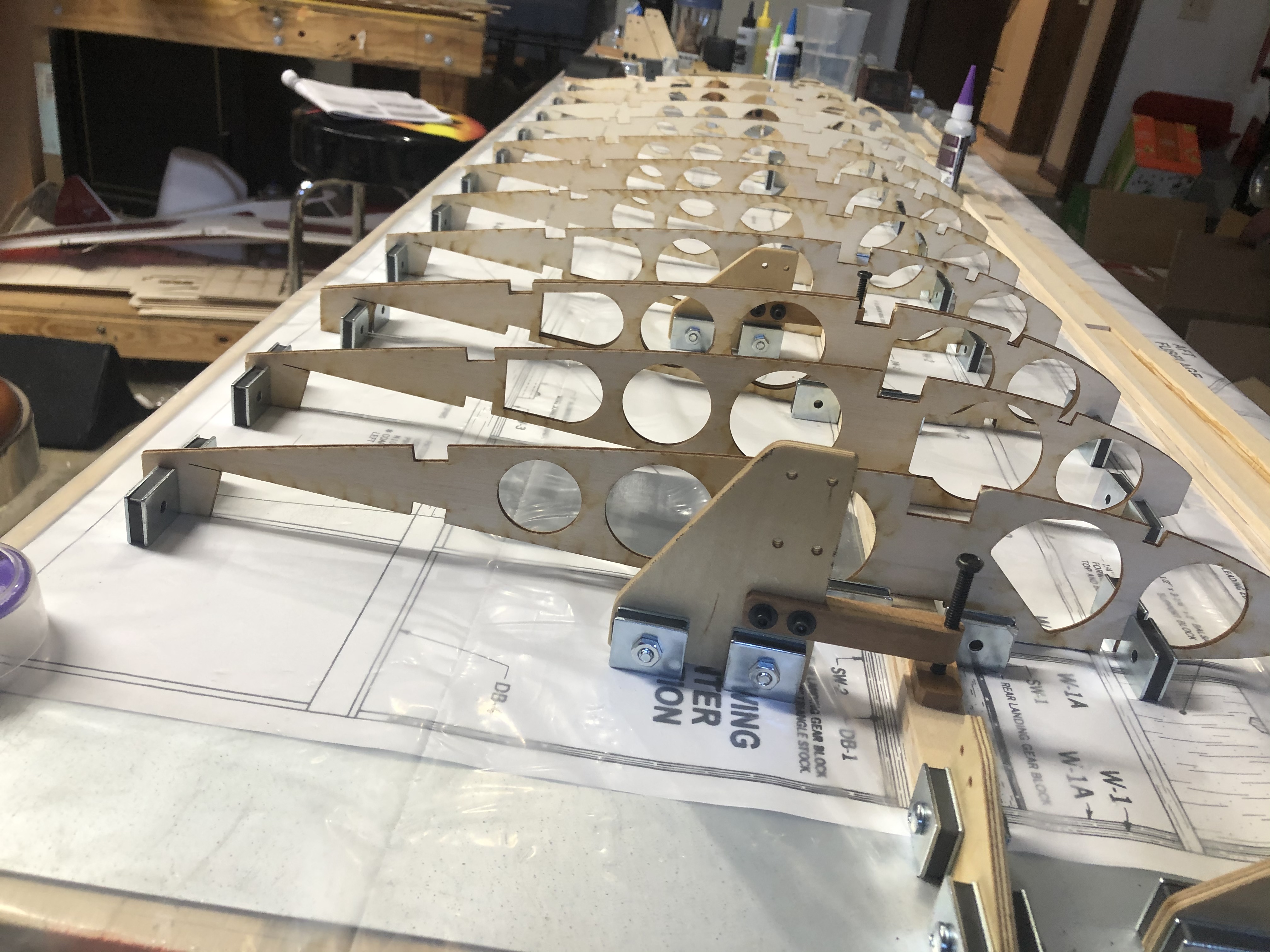

Laminated main spars and started wing.  Using a magnetic building board

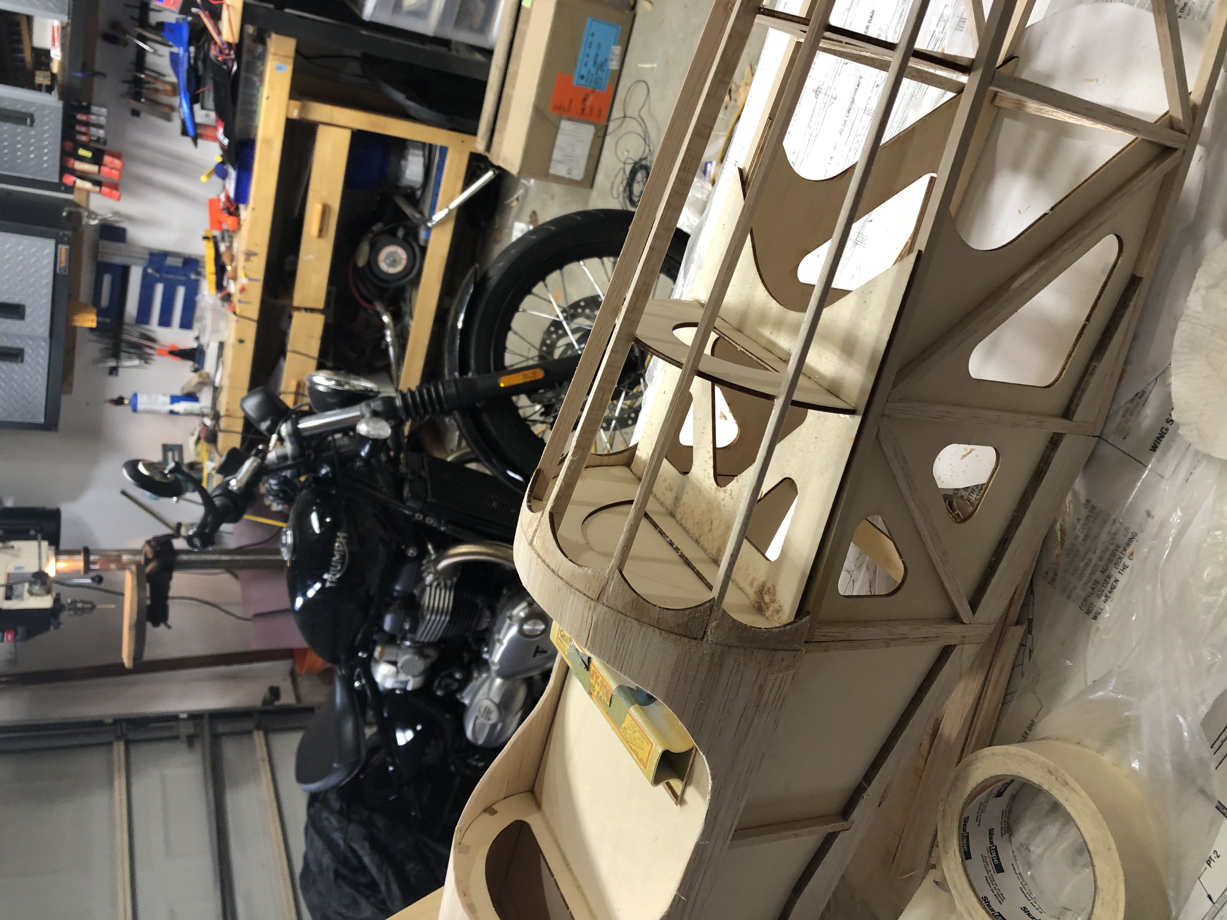

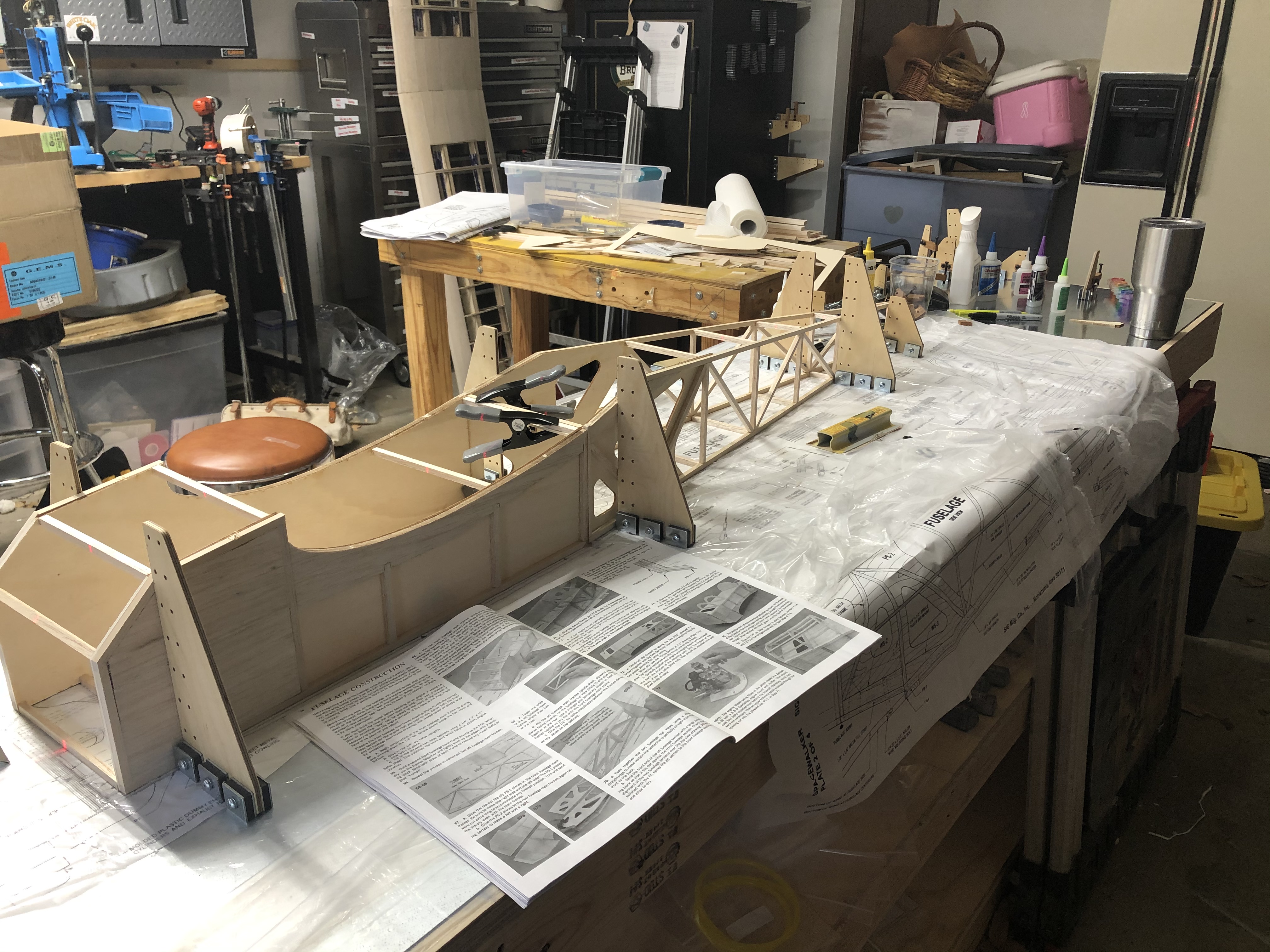

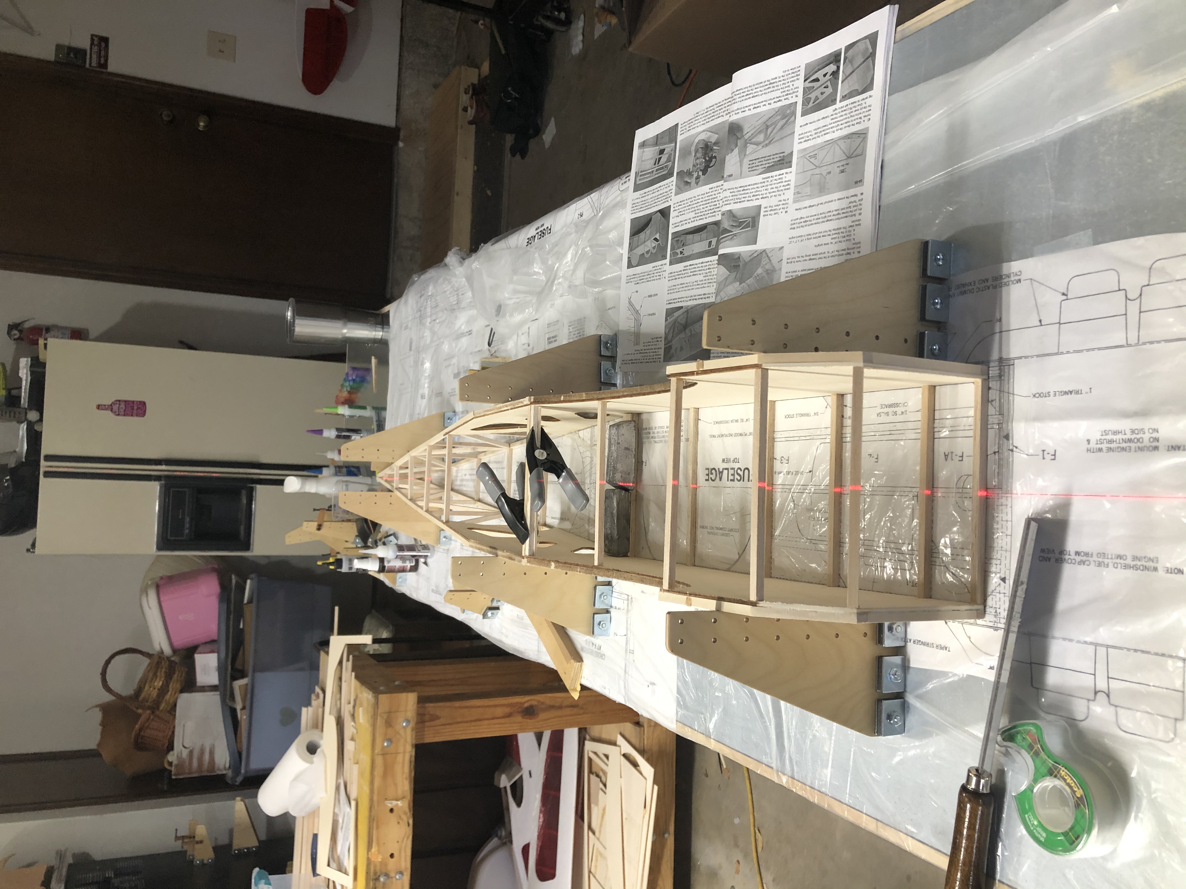

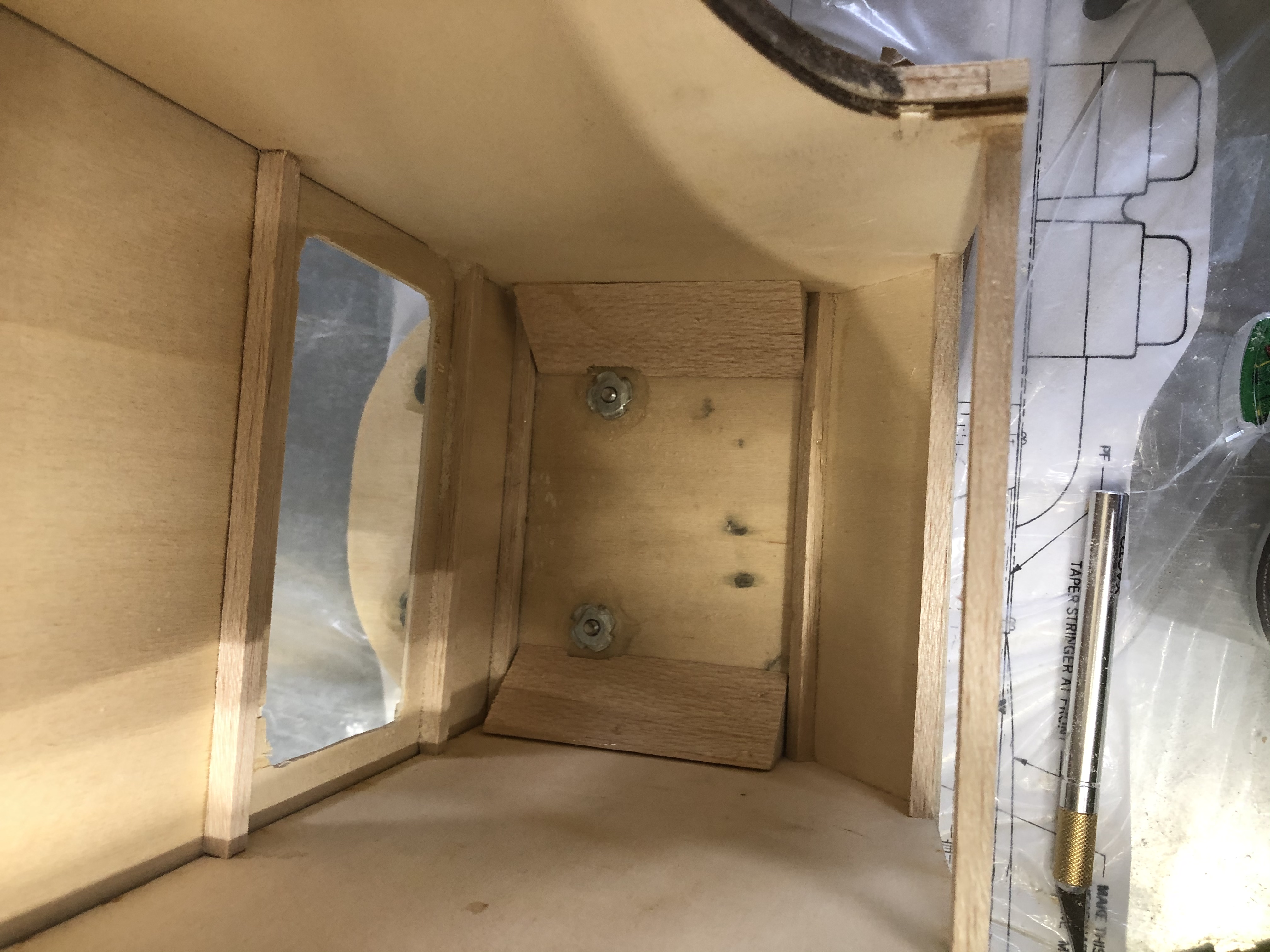

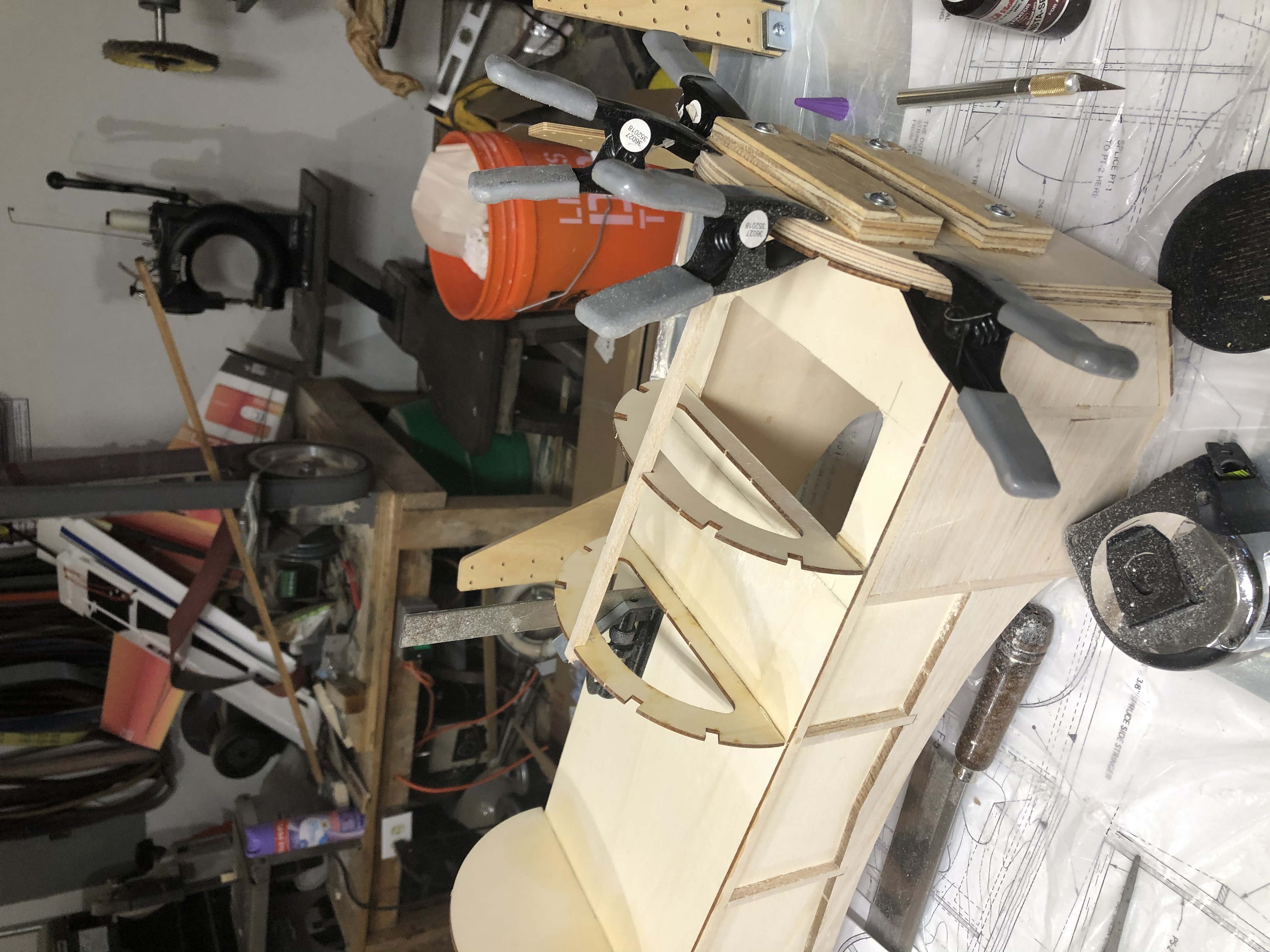

Started on Fuselage.  Planning on using a Zenoah G62,  so I had to push firewall back slightly.

Thanks the building jigs come from Airfieldmodels.com.  I like it much better than the old ceiling tile and pin method.

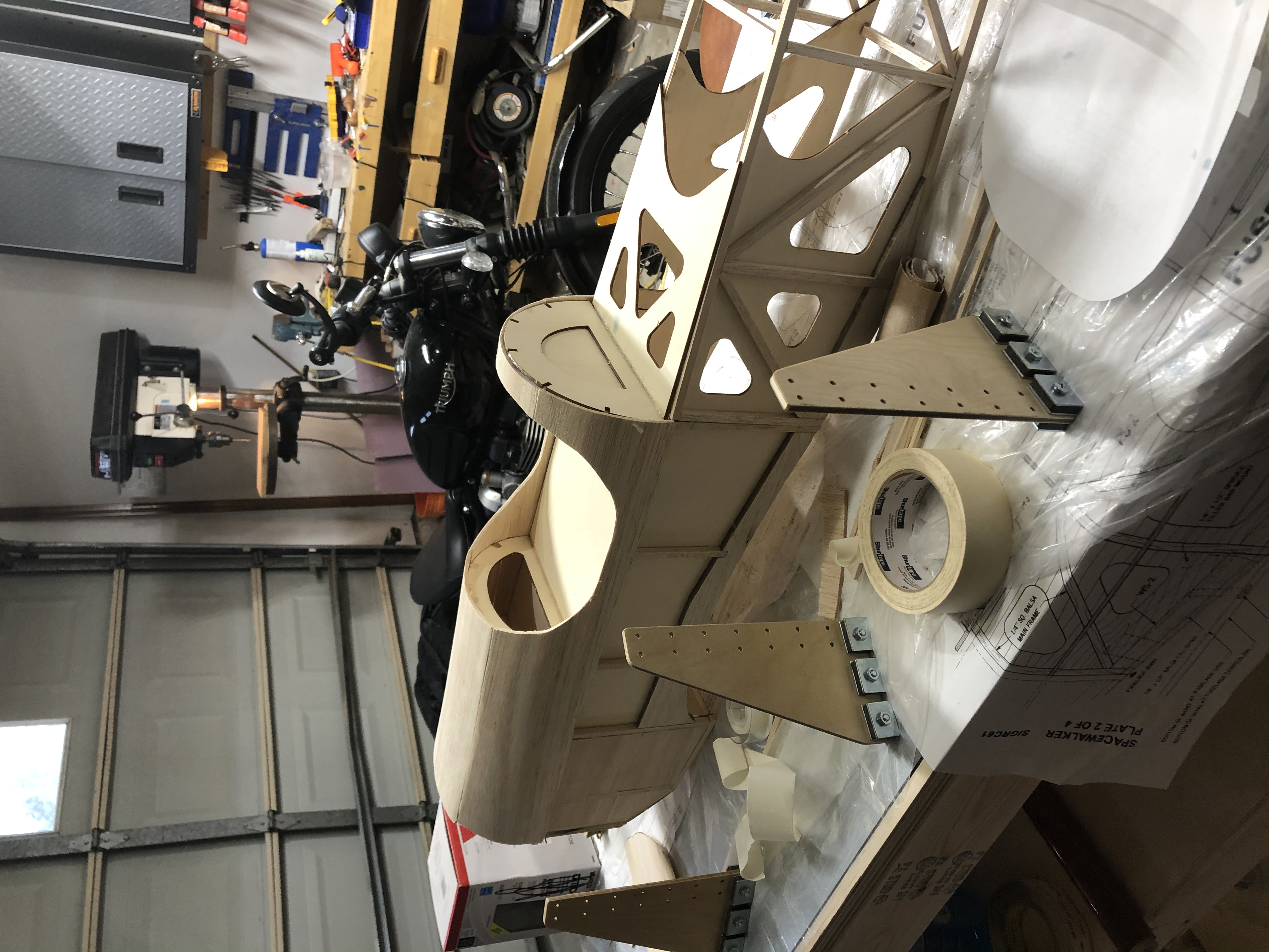

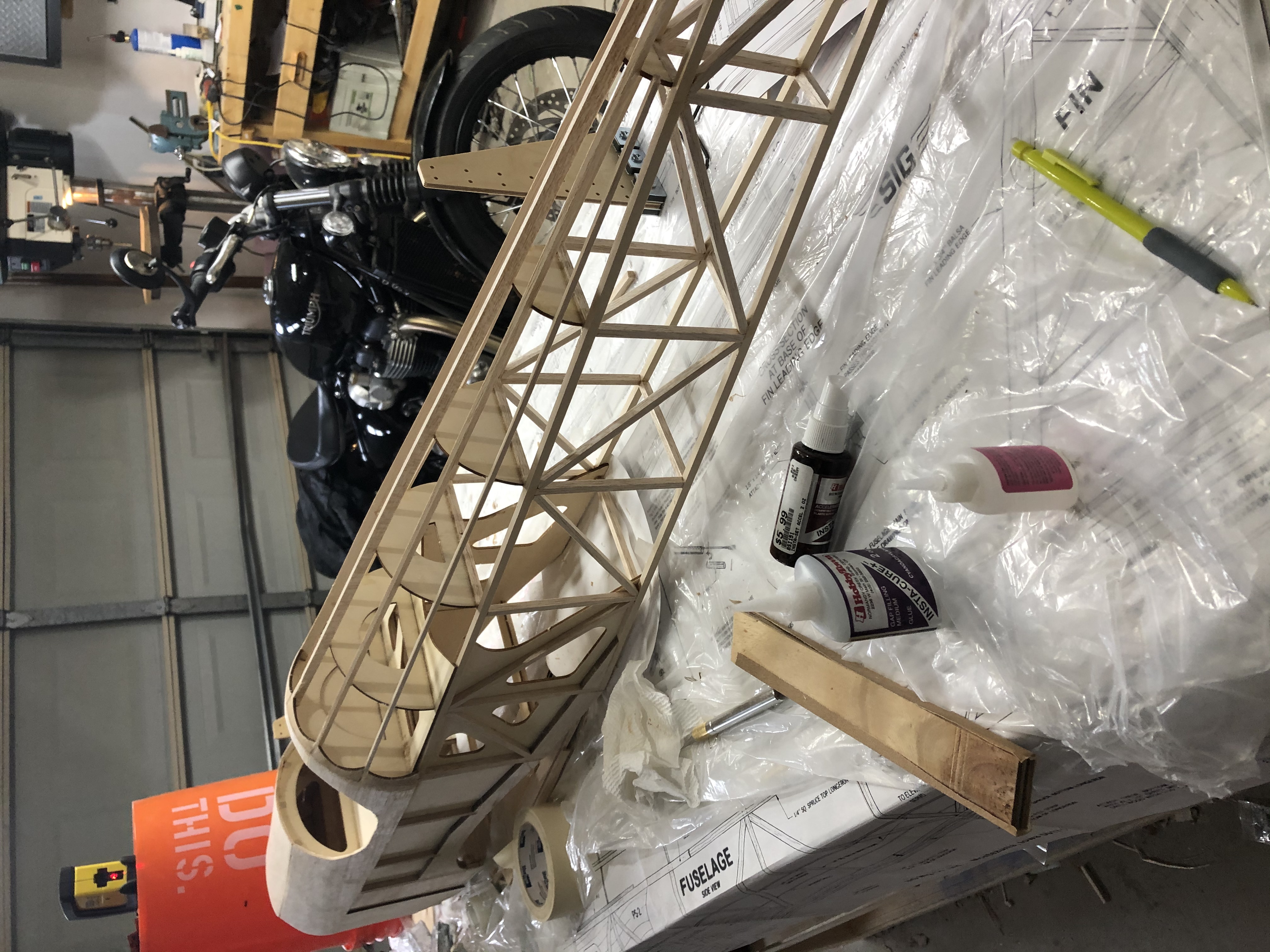

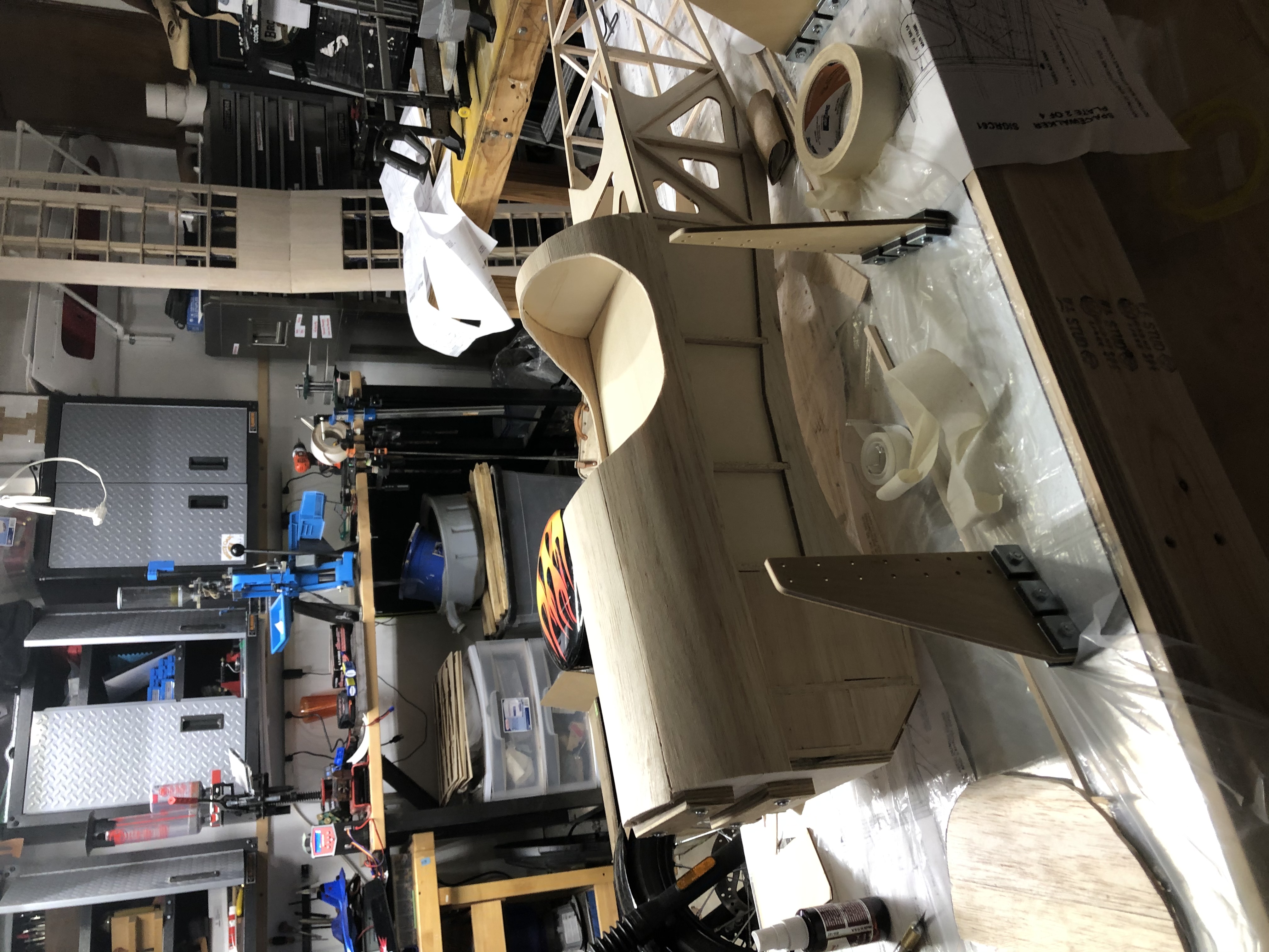

A little cold in the garage today but I got the top of the fuselage sheeted and cockpit cut out.

Planning on using a Zenoah G62.

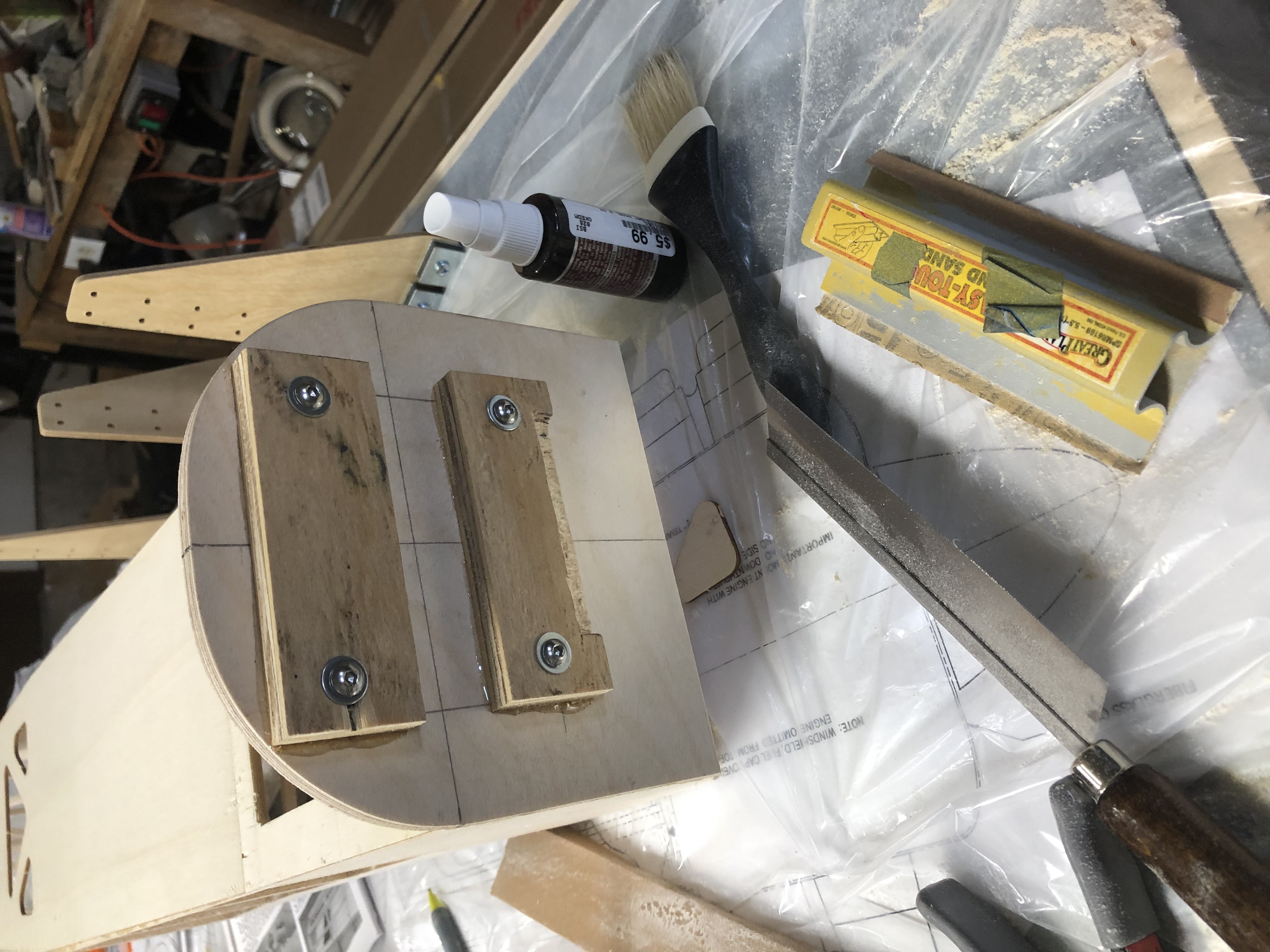

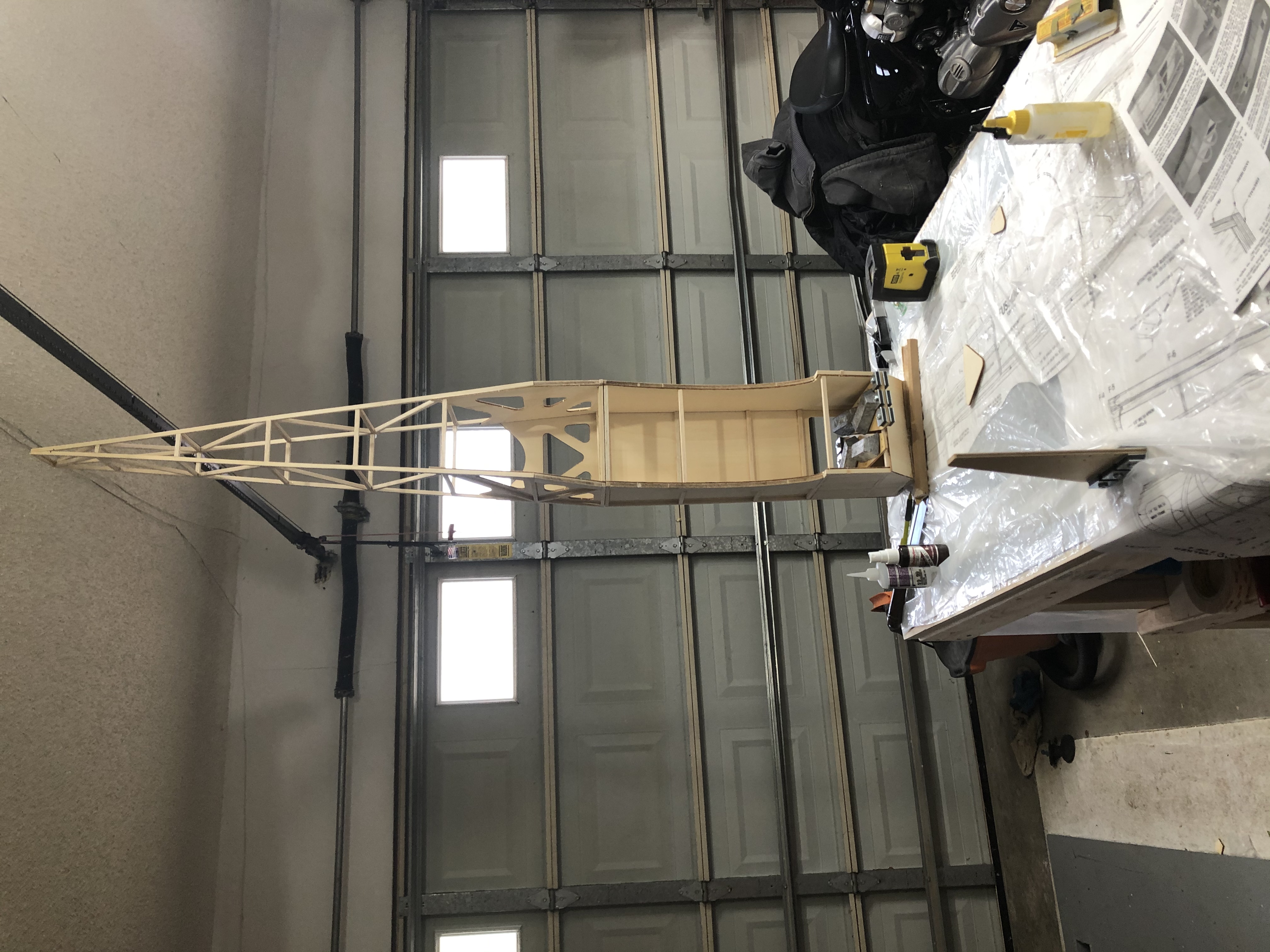

Worked on rudder and fin yesterday
