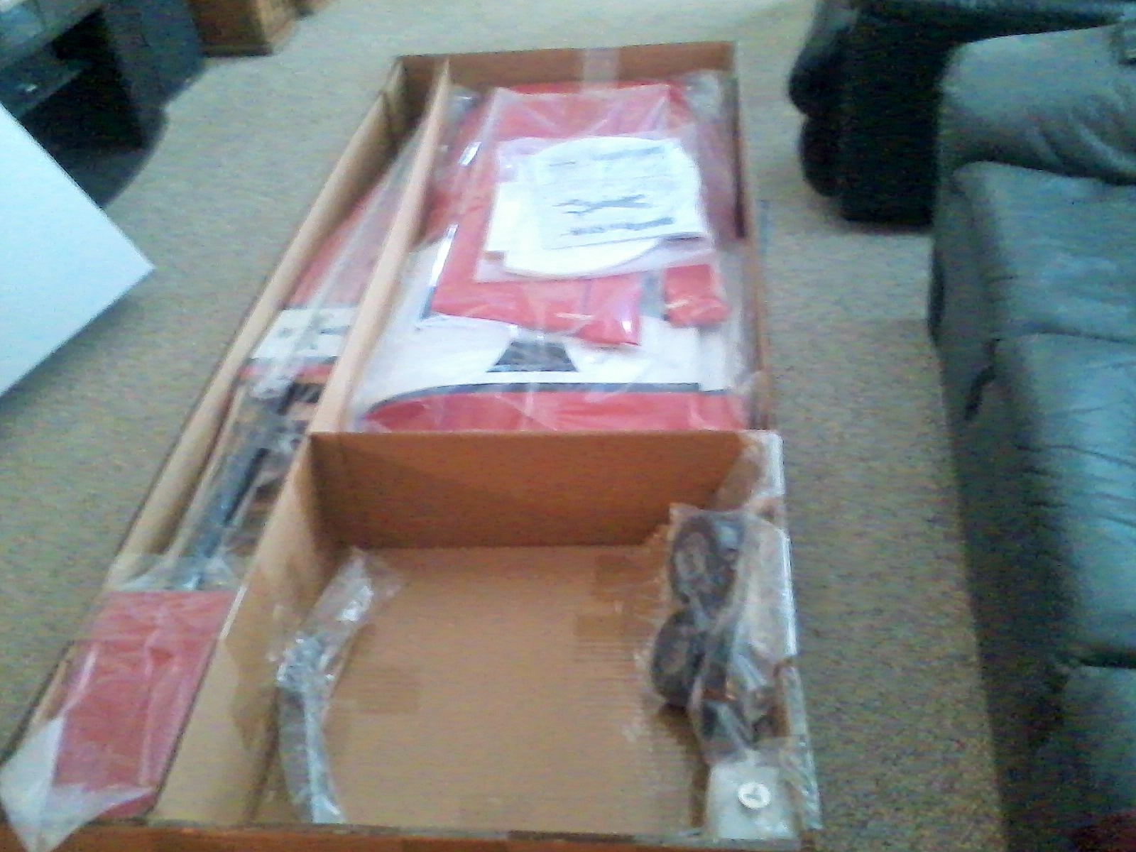

Well I looked in the box today. At least that's a start. More to come later.

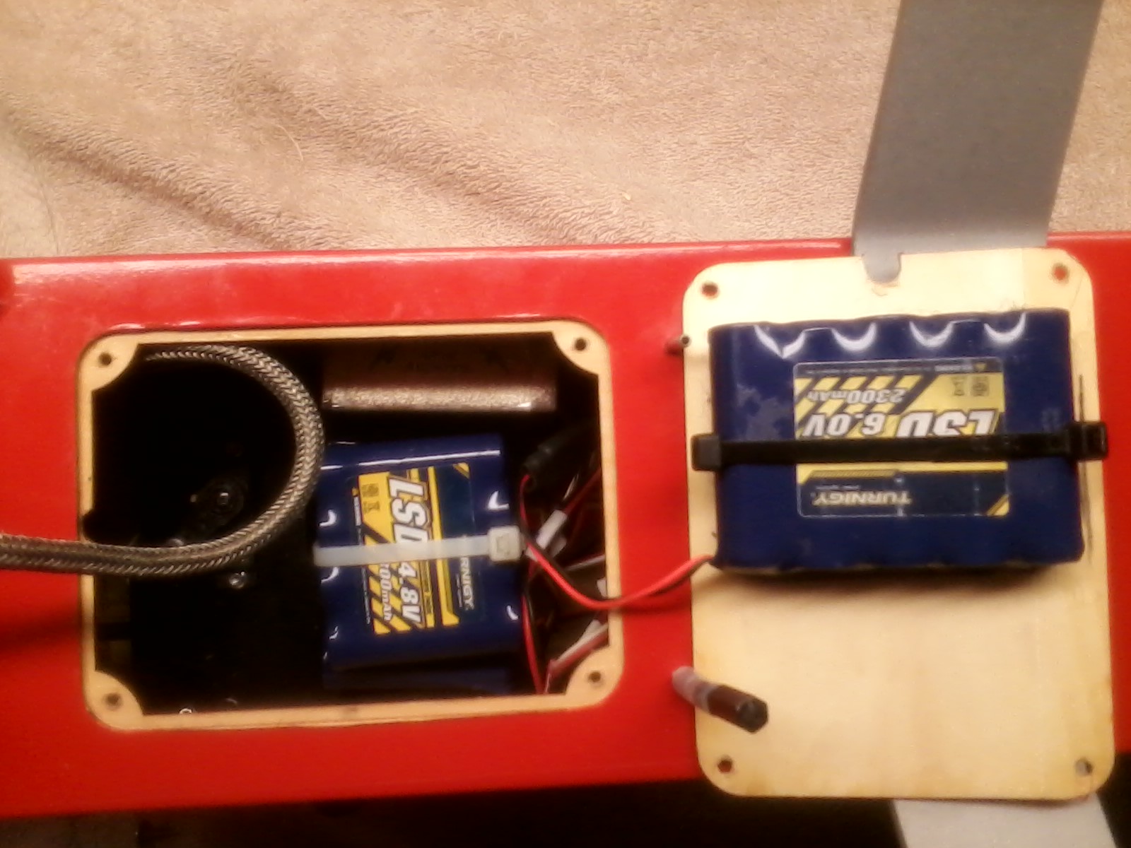

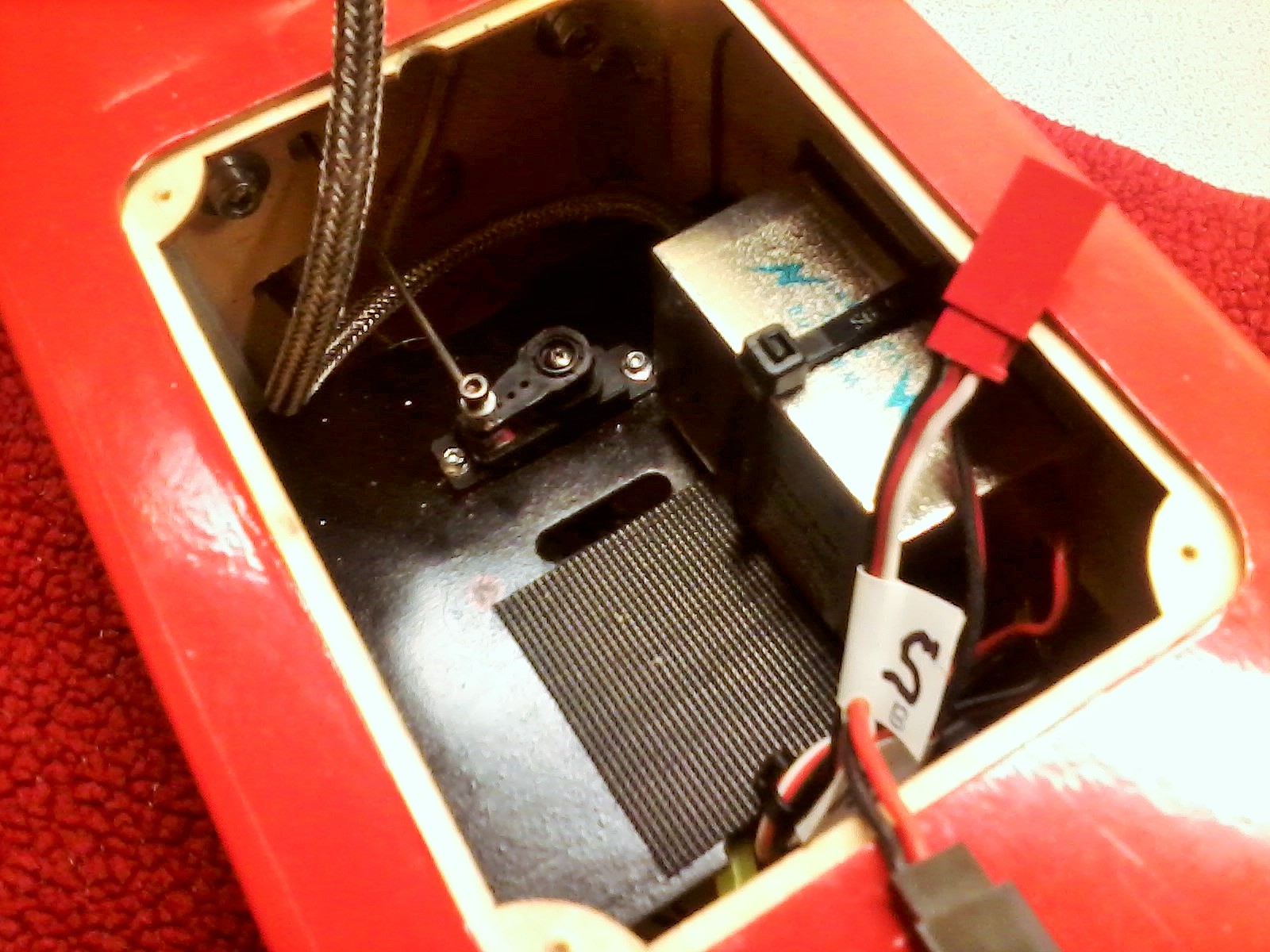

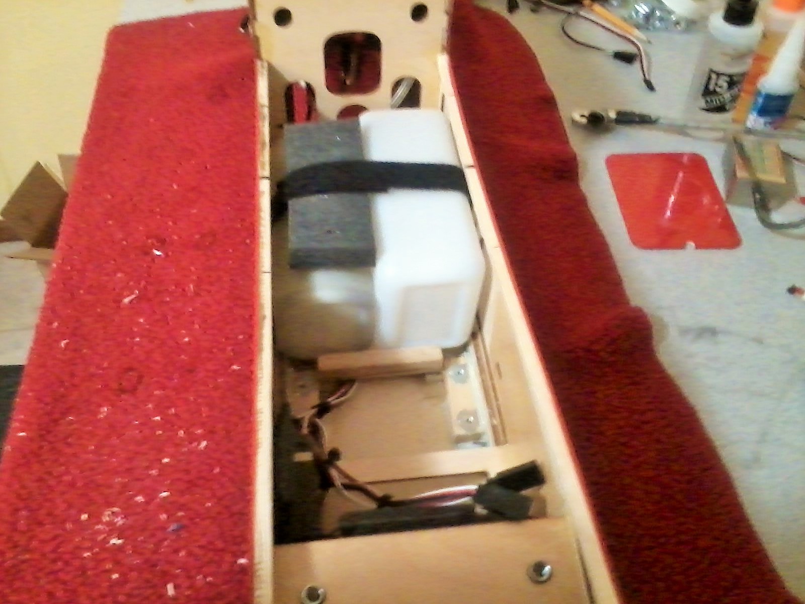

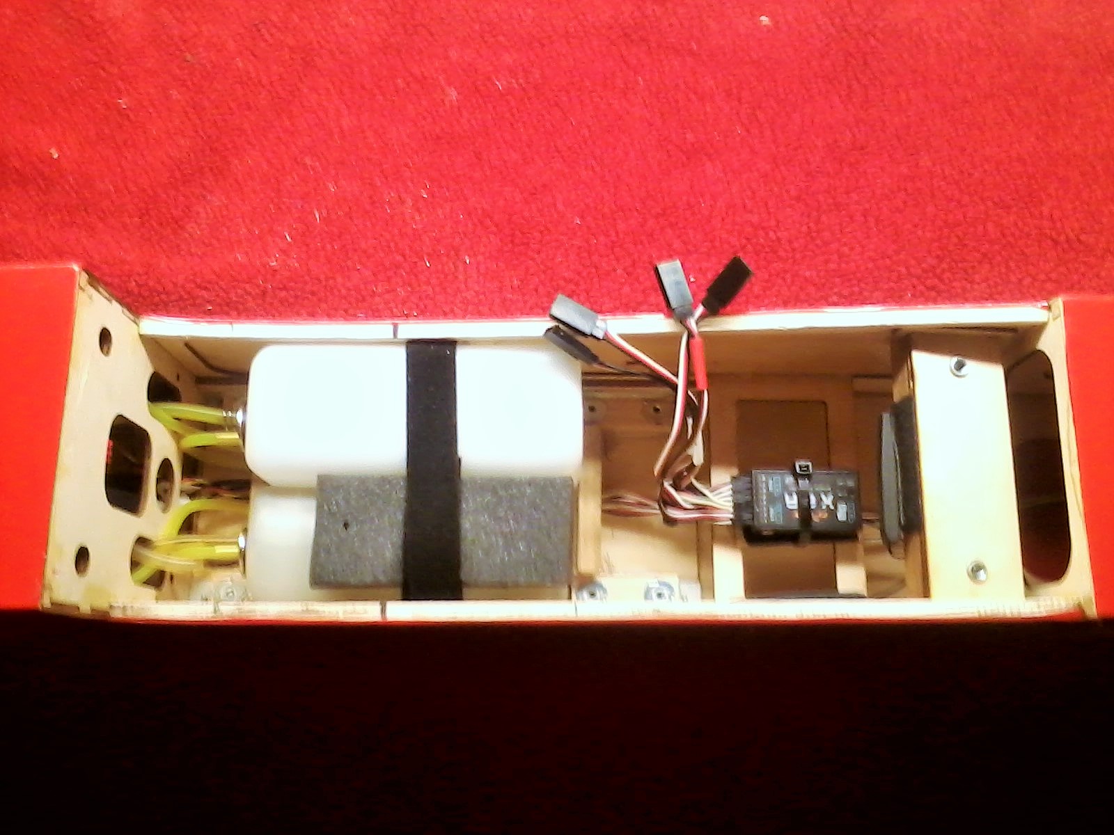

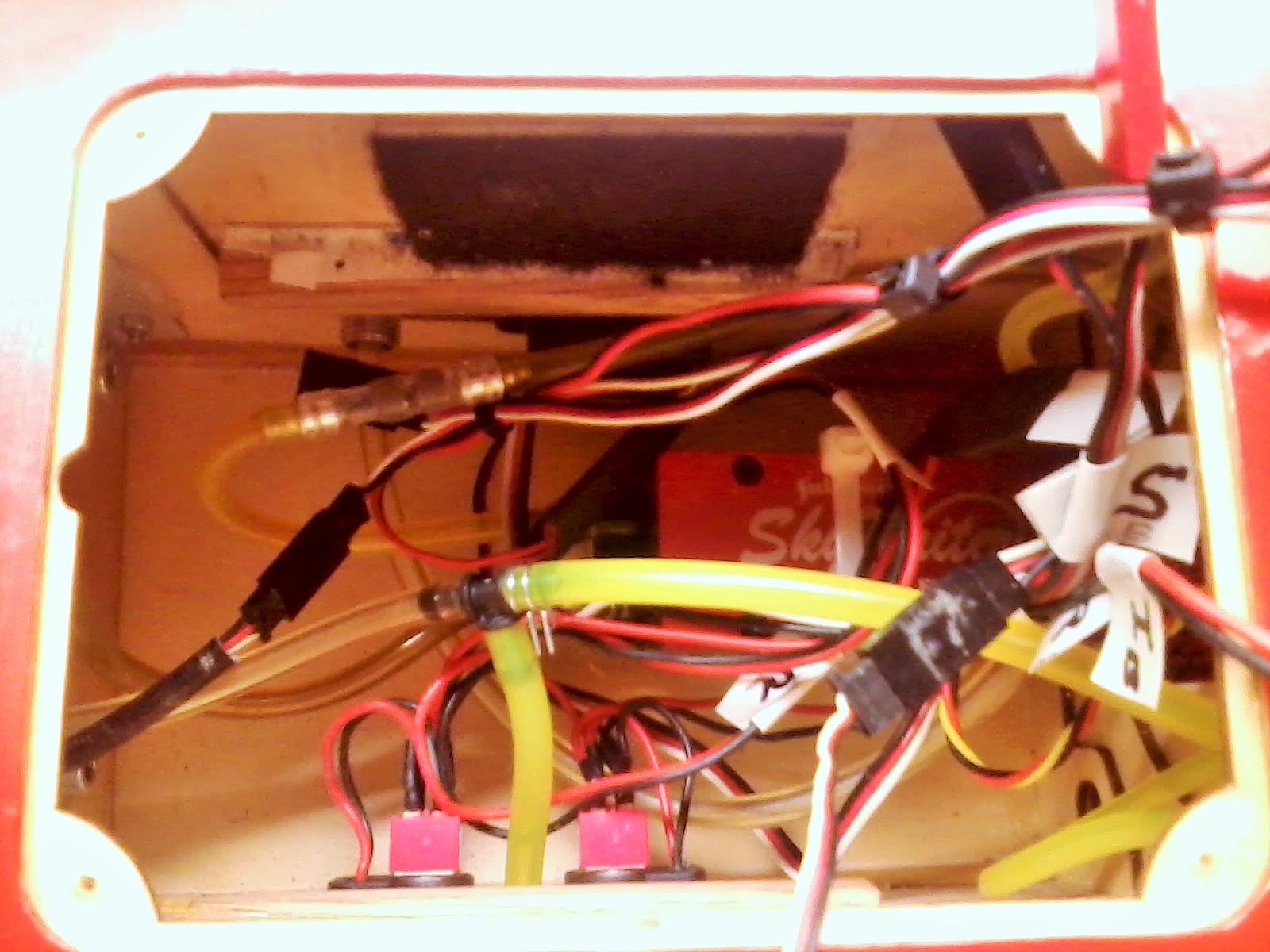

I'm still working on the Stik. On utube the biggest complaint was the plane tends to be tail heavy , so I'm going to put all the things I can in the nose of the plane. It's getting a little crowded. I created a raised floor so I could put some below and some above.
A list of things in the nose.
throttle servo
ignition module
4.8 volt ignition volt battery
6 volt receiver battery
6 volt smoke battery
smoke pump
switches
all related fuel lines.

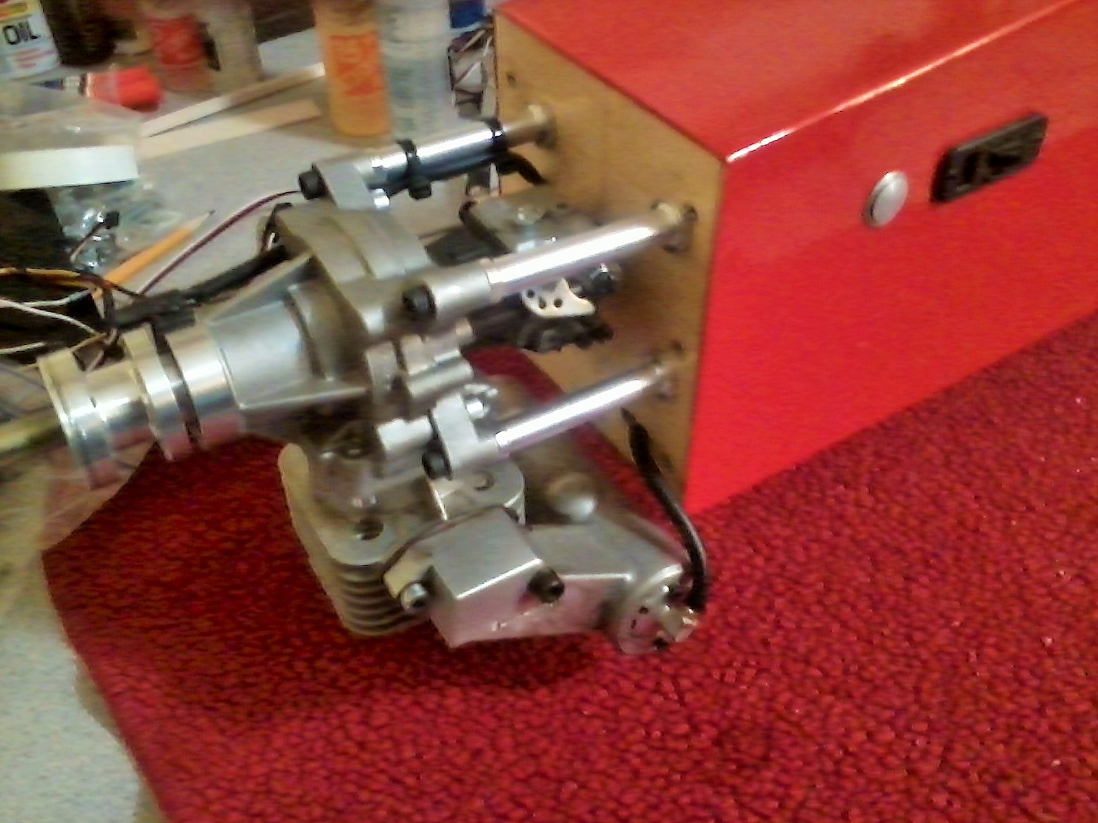

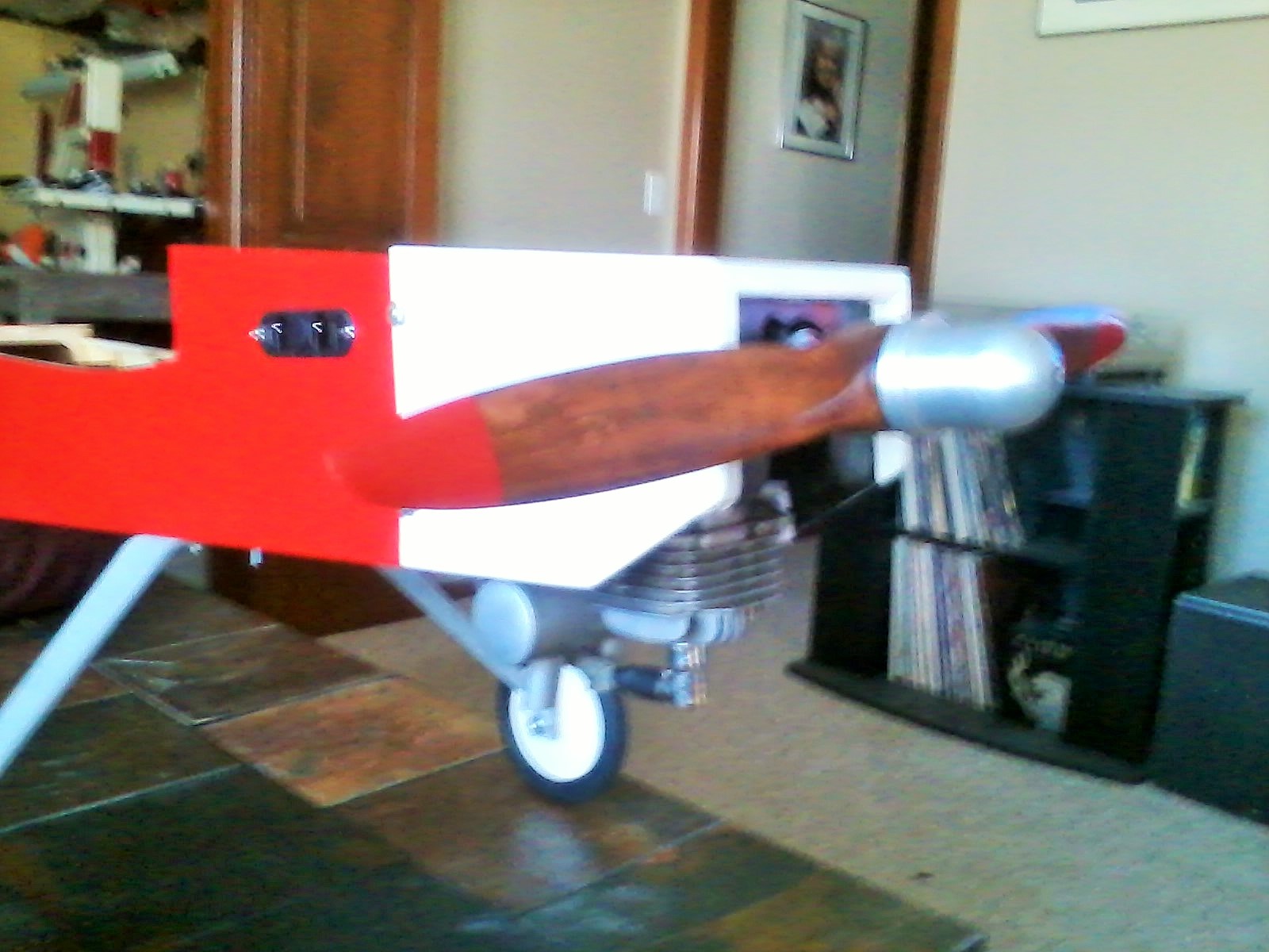

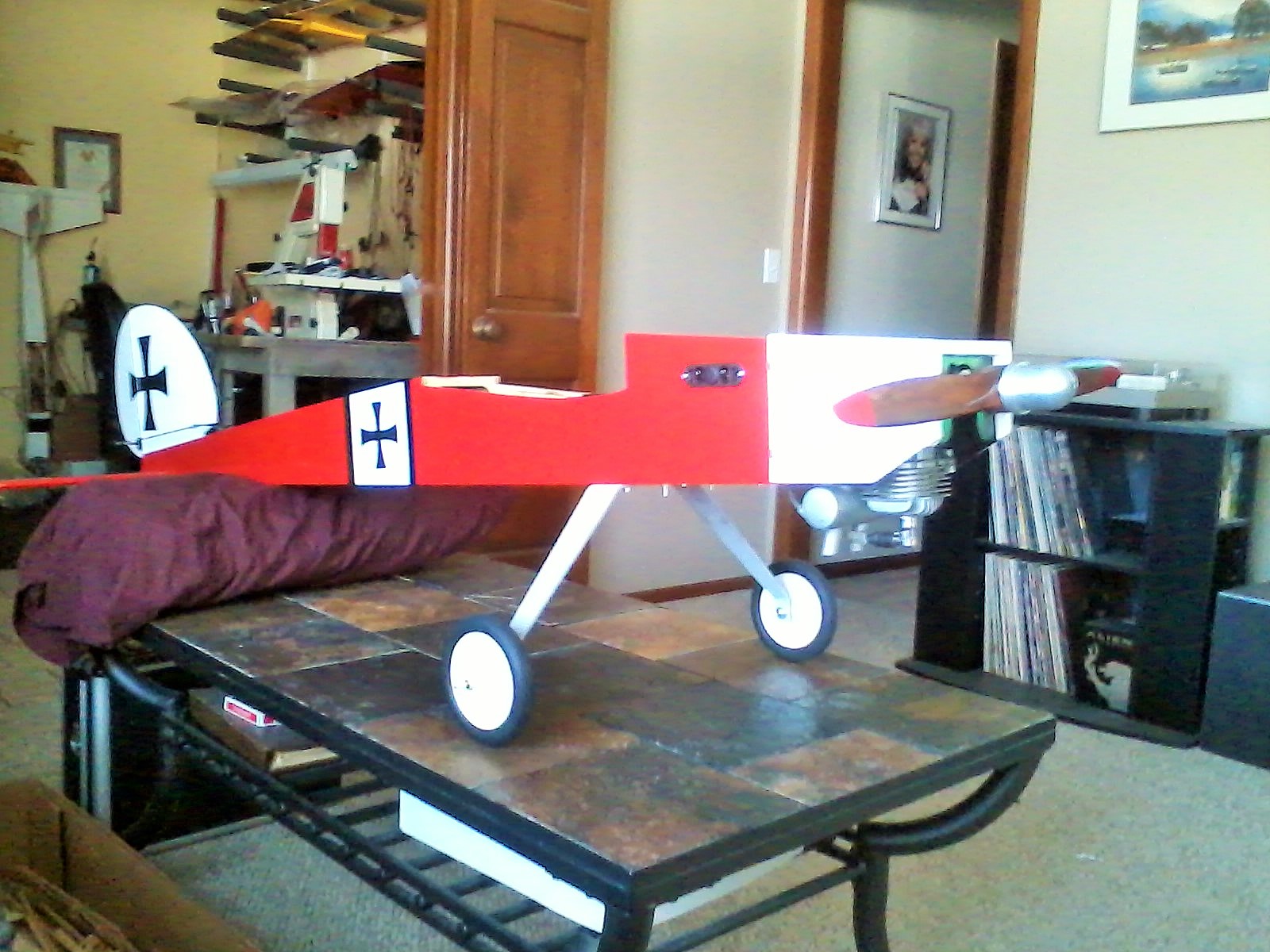

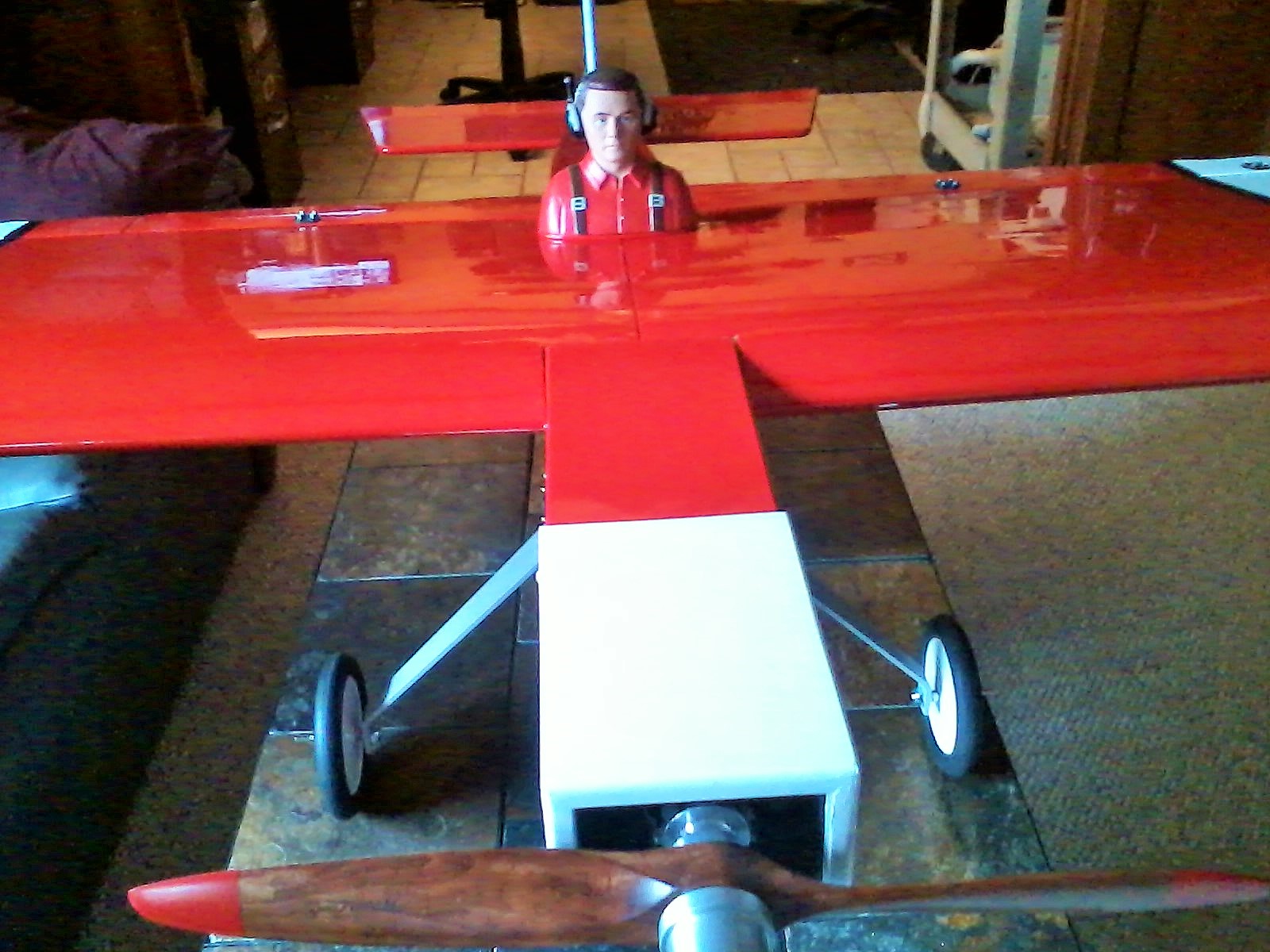

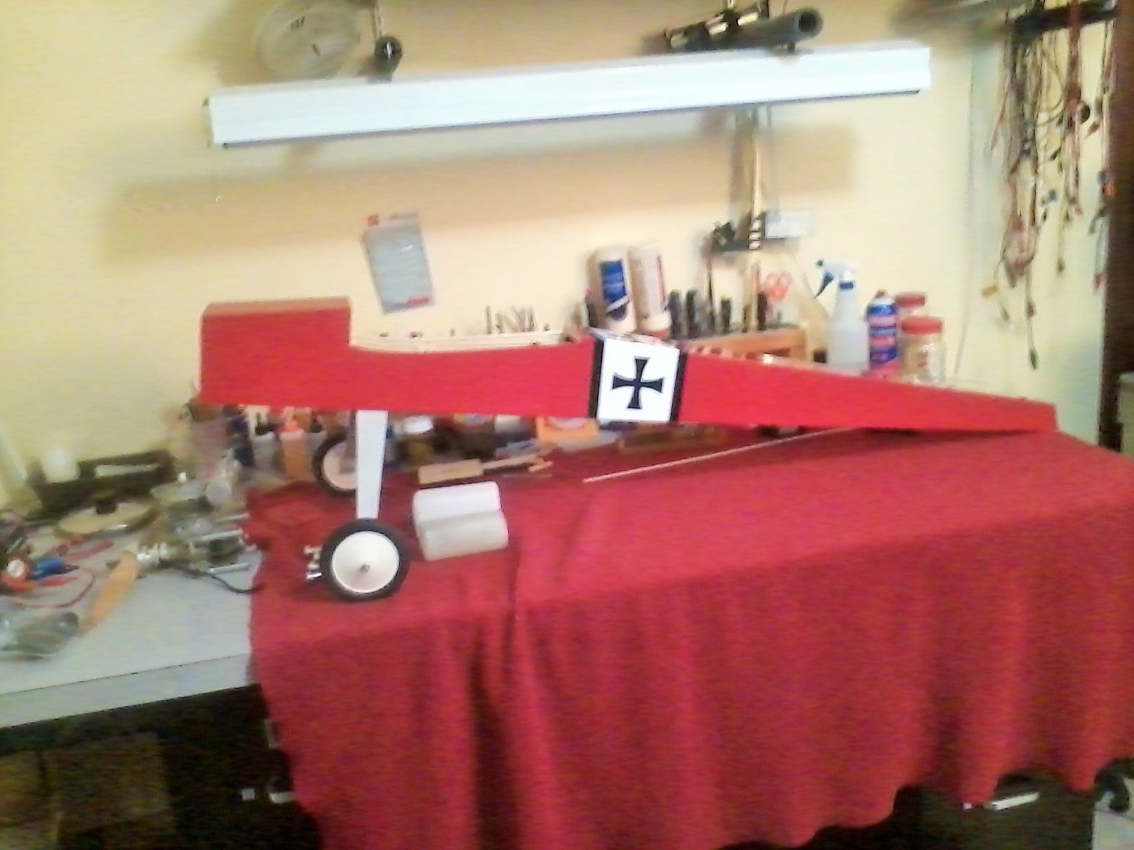

I made a cowl to cover the engine, It gives it a more finished look.
Also, the wheels are not the ones that came with the ARF. They are ones that someone gave me. Looks more like a world war 1 airplane.

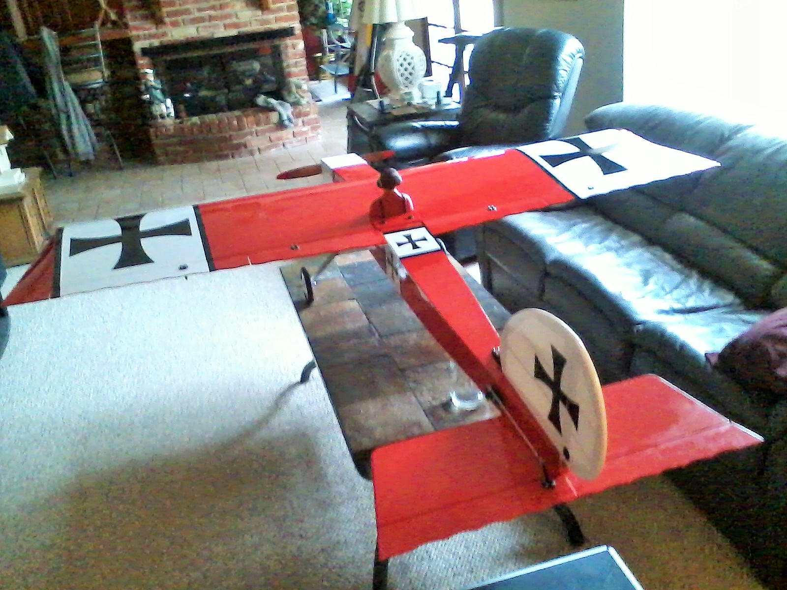

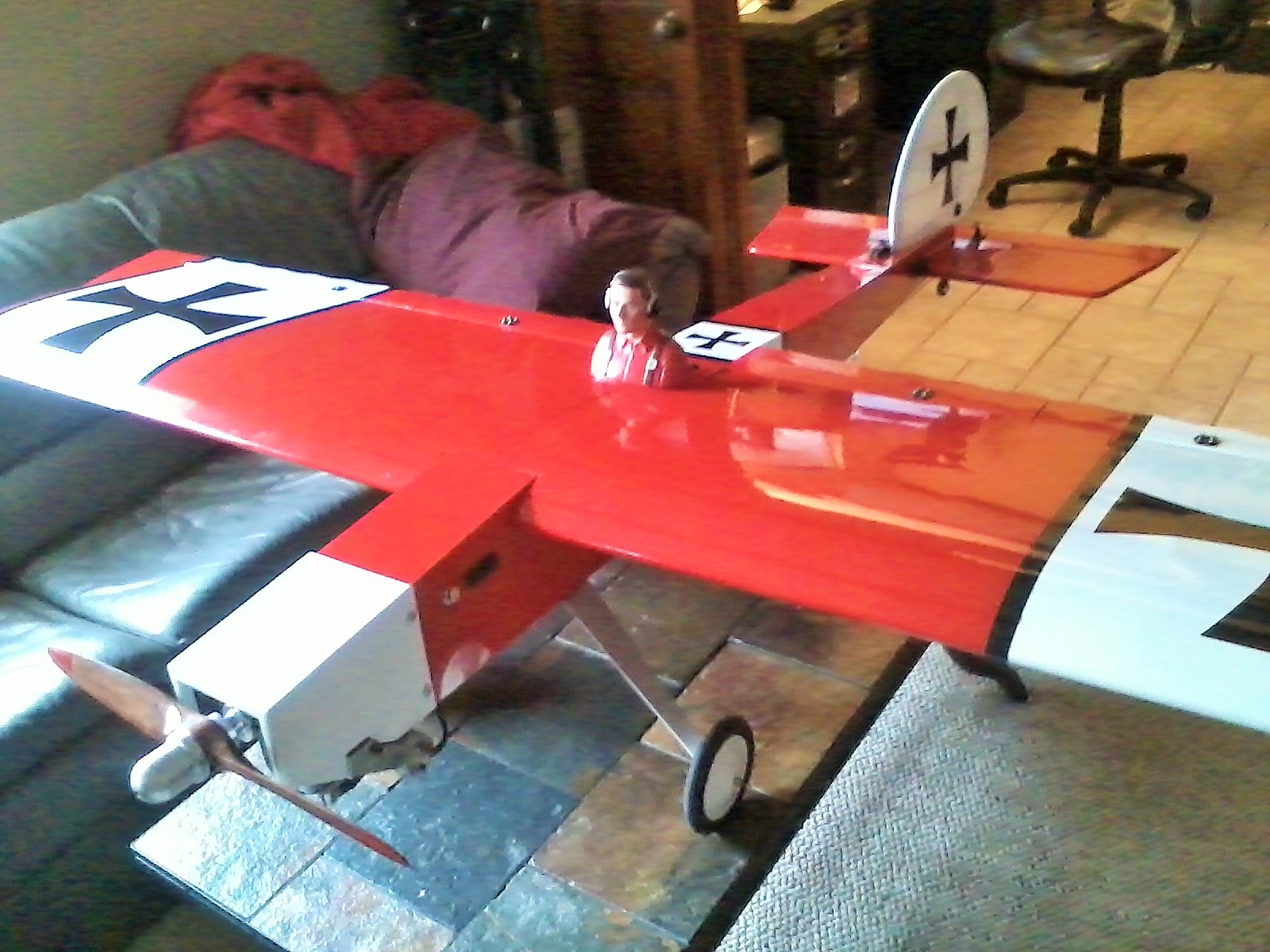

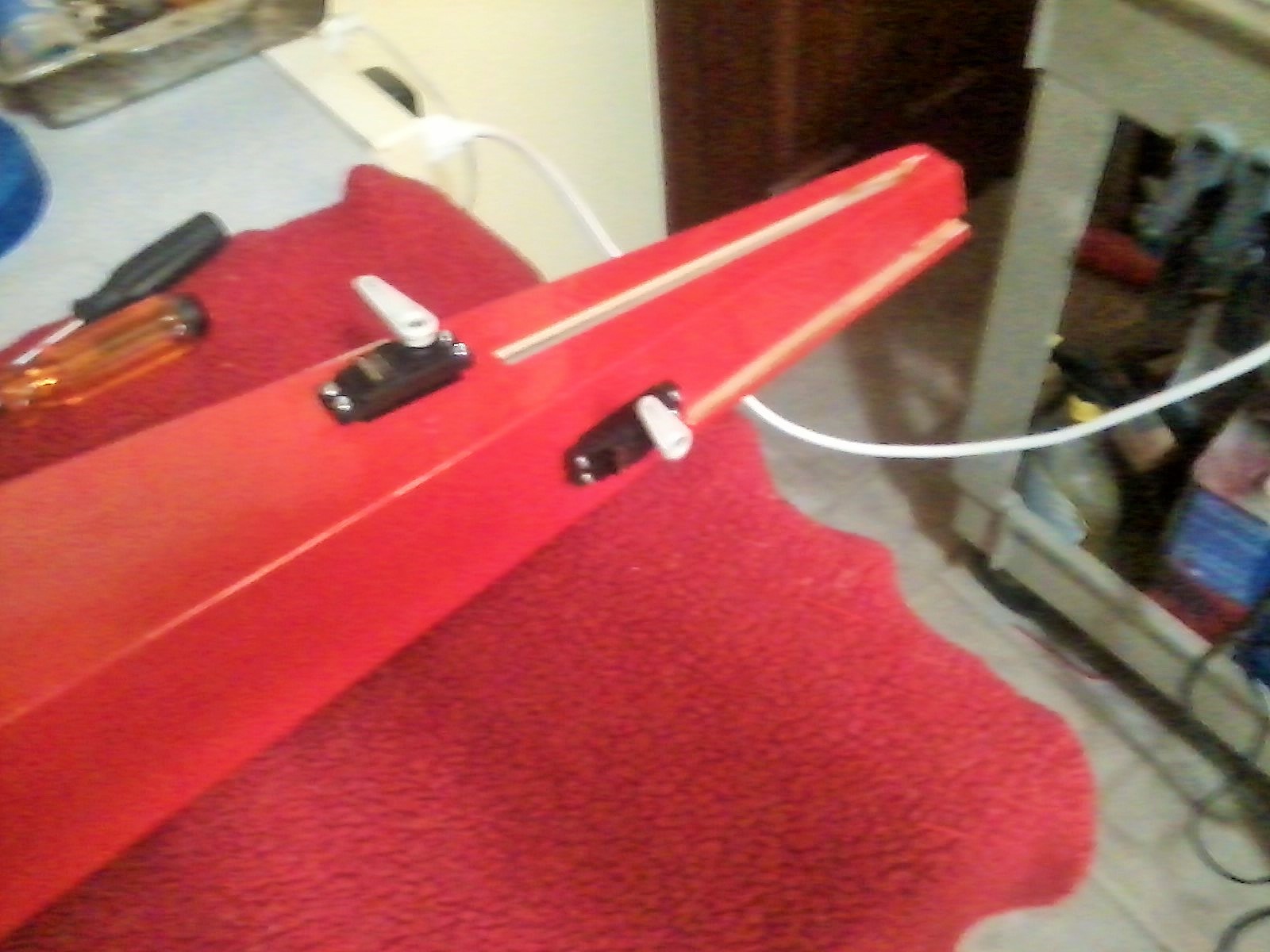

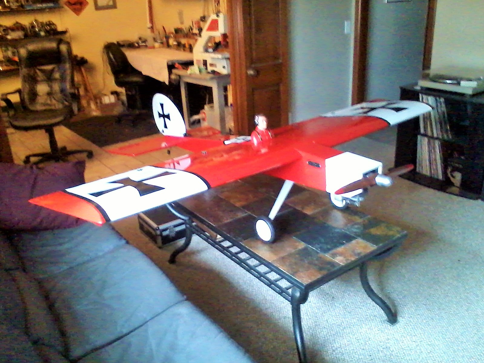

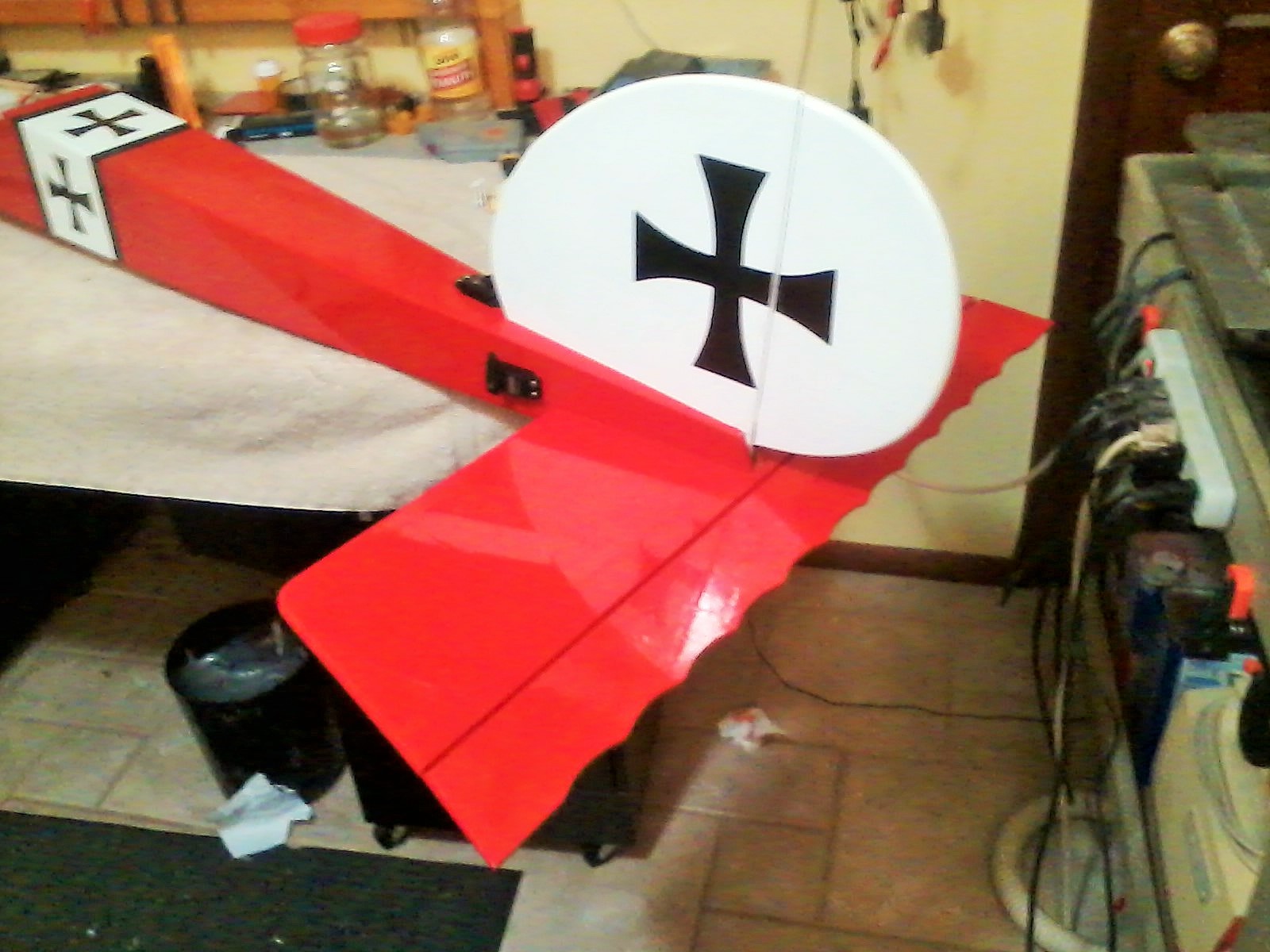

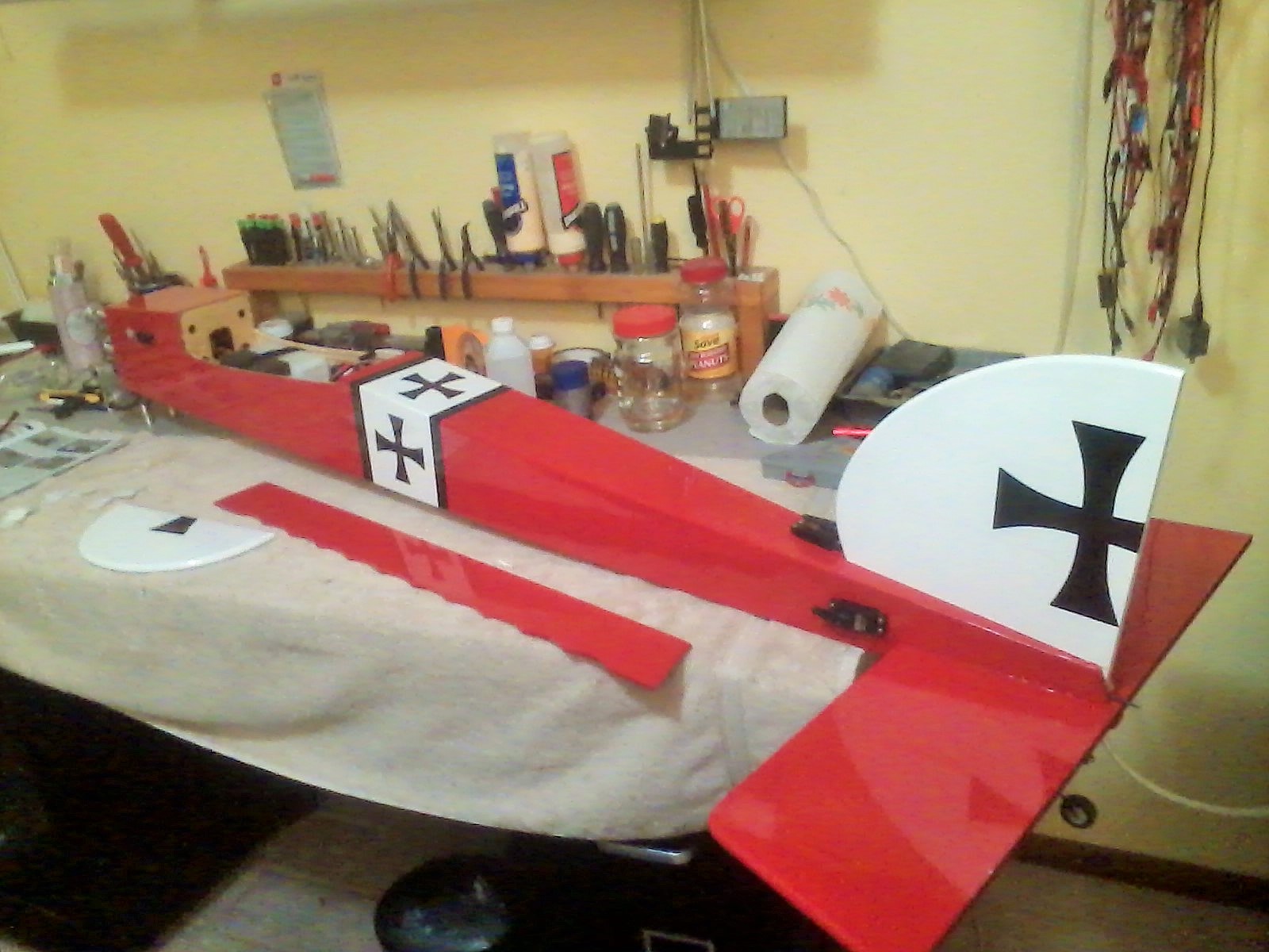

Things went a lot faster when I got to the wings. All I had to do was install the servos and CA the flaps and ailerons in the precut slots. The wing is in two pieces with a wing tube. I decided to put a Pilot I had on it. I had to make a plate to mount the pilot on and join the wing together,, Even putting all the weight I could in the nose ,it still needed 10 oz. of weight on the fire wall to get it to balance on the recommend CG. All done, the total weight came out about 14 lbs. It should have unlimited vertical .
The Stik is ready to test.
