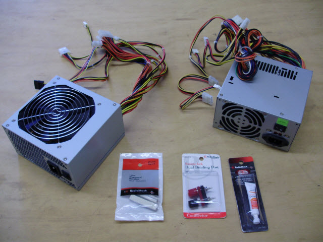

Find a PC power supply, in the photo below you'll see that I had two different models to select from for this project. Here are the power supply 12V specifications.
Left Power Supply: 350Watt 12V output rated at 15amps, According to the name plate. I chose this one for the project!
Right Power Supply: 300Watt 12V output rated at 13amps, again according to the name plate

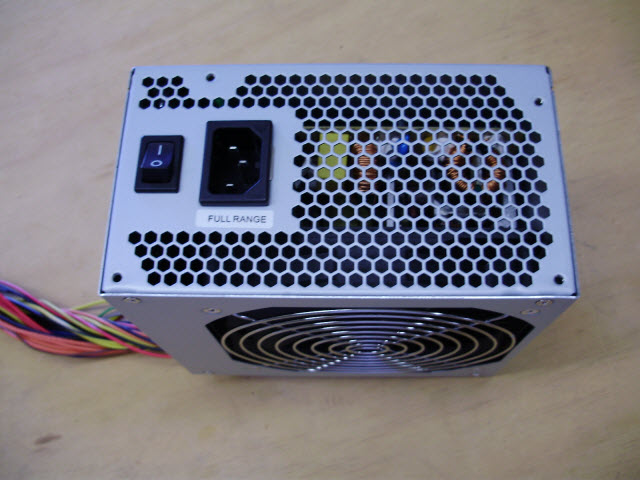

I'm not sure you can tell by the photo but both units had a switch located on the back to turn the power supply off / on. While not all power supplies have such a switch this does allow you to skip a step in the modification process.

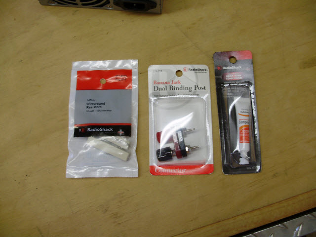

Listed below are both a parts list that I needed to purchase including prices (Radio Shack) and photos showing the items?
1 package of 1 Ohm wire wound resistors, this includes two resistors and of the three power supplies I have converted I only needed one per conversion.
RS part #2710131 $2.19
A small amount of Heat sink compound, this helps transfer some heat from the 1 Ohm resistor to the power supply case. I have read various opinions if this is really necessary or not but I just thought that it couldn't hurt too aid the displacement of heat! The tube you see in the photo below would be enough for at least 50 power supply conversion.
RS part #2761372 $3.29

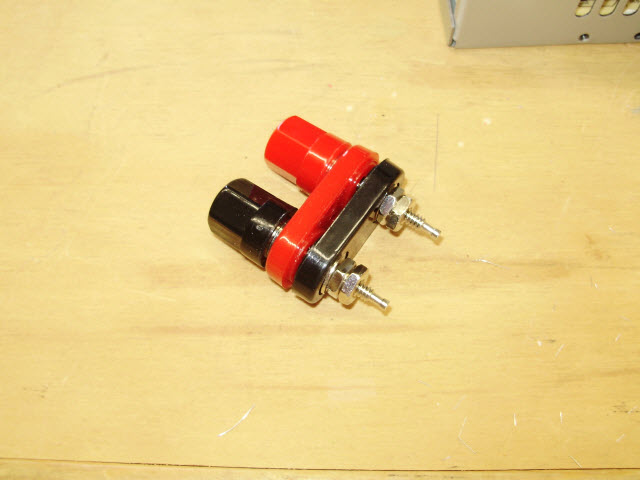

A method of transferring the power from the power supply to your fast charger, cycler or whatever you need to power. I choose a dual binding post banana jack that you can either plug in a banana jack into it or you can unscrew it and directly connect a wire.
RS part #274-718 $5.29
Notes: Other types of connectors are available, the one I selected just so happens to be one of the most expensive options (go figure)

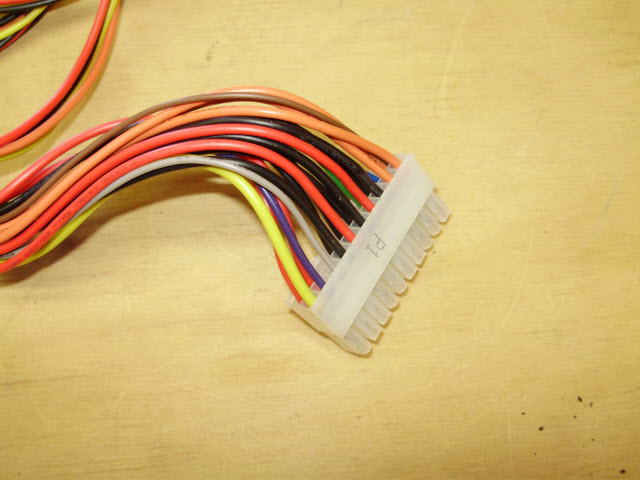

Remove The Excess Wires and Connectors

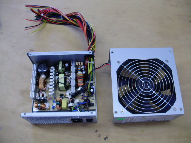

The first thing to do is to remove the cover off the power supply and cut or desolder most of the wires leading out of the case. Cutting them and using heat shrink to isolate them is much easier and faster than removing the power supply circuit board from the case and desoldering them, but either way you decide to go make sure and leave 1 green, 1 red, three yellow and 5 black wires that will be used later in the project. Many suggest that you only need one yellow and 3 black wires to complete the conversion but my thinking is that the wires are there and since the power supply in this case is rated at handling 15A @ 12V why would you only use one single 18 gauge conductor to handle that load, not that we will ever need that much power. But I just didn’t cut as many wires back and have left three 18 gauge conductors of each color for both the 12V positive (yellow) and negative (black) terminals!
Note: This picture was taken before I trimmed back the wires the last time, later pictures will show this!
Now it’s time to heat up the soldering iron and begin wiring modifications. Just a reminder, be sure to cover all the exposed conductors from soldered connections with heat shrink tubing. In my project example the only soldering required was to install the 1 Ohm resistor. Yes you could solder more if you want to but soldering skills are not my strong suite so I figured ways to keep that to a minimum...You’ll see!
In this picture you will see where I cut back all the unused conductors to their final length and have heat shrunk them together so they can’t short out against other components. If you look closely you will see I left the 1 green, 1 red, three yellow and 5 black conductors as mentioned earlier. Later steps and pictures will depict the conductors clearer.

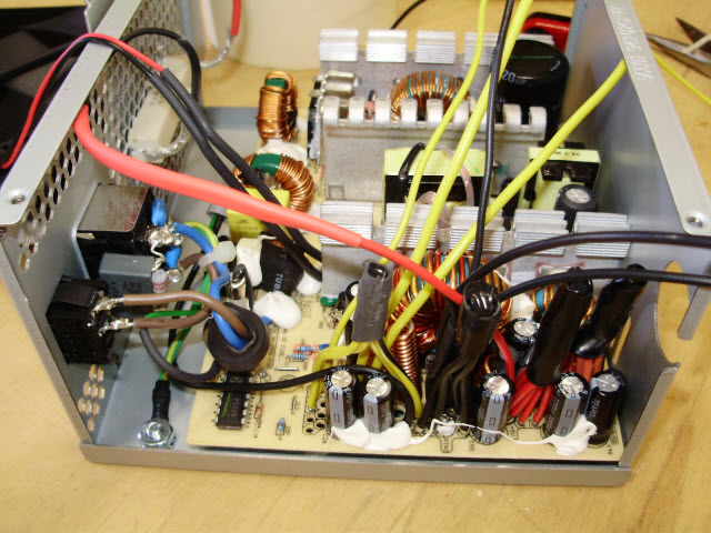

Wiring Modifications
The green wire that you have left longer in the earlier step is normally used to turn the power supply on and off (granted your power supply had a two row connector similar to this picture.
If your power supply has a case mounted power supply next to the fan on the back like the one (picture below) just solder one black wire to the green wire and this will allow the power switch on the back to operate the power supply. If your power supply doesn’t have a case mounted switch and you want to add one, solder the green wire to one switch terminal and the a black conductor to the other terminal. Then drill a hole in the case and mount the switch.
If you really look closely you can see the gray wire nut at the bottom of the picture (remember I hate to solder) on the green wire and one black in the unit I converted.

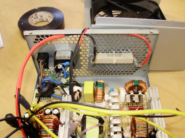

The next step is to install a load on the 5 volt circuit. The purpose of this load is to bring the yellow conductors (12V positive) up to over 12 volts. The photo below is from my installation and only required one resistor to reach my target voltage of around 12.3 volts but some power supplies require two resistors wired in series to achieve 12 to 12.5 volts. You just have to test your particular supply prior to soldering the connections
As you can see I decided to solder the resistor in between the one red conductor left in the earlier step and one black conductor, then I used some clear heat shrink to cover the exposed conductors on the resistor. Wire nuts work here as well but you need to make sure and cover all the exposed conductors with heat shrink so they don’t touch anything! I then used (1) small wire tie to hold the resistor to the back of the power supply case but not before running a small bead of heat sink compound between the case and resistor to dissipate some heat. FYI this resistor gets hot, don’t ask how I know!
Note: I have later learned that due to heat from the resistor that the plastic wire tie might break down in a very short amount of time. The easy solution is to replace it with one or two wire bread ties (with the plastic or paper removed) instead of the plastic ties. The metal from the bread ties can easily handle whatever heat is released from the resistor!

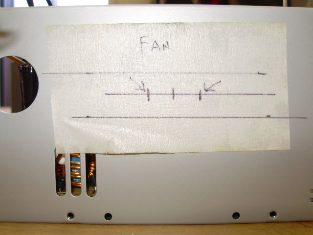

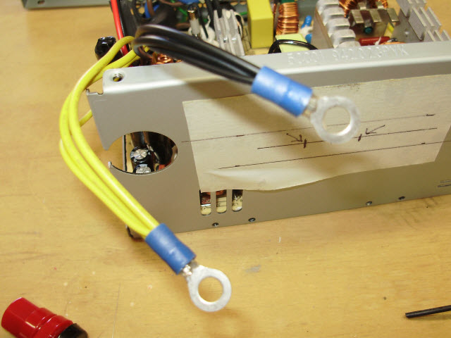

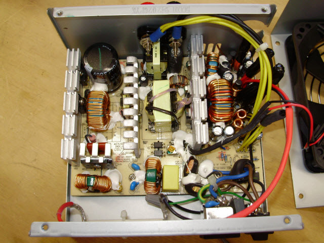

The remaining yellow and black wires (three each in my example) can now be tied to the terminal posts that were purchased. But first I needed to drill the required mounting holes in the front of the case to mount the binding post. Included on the back of the binding post packaging was a template to use for drilling the holes, see picture below for what it looks like transferred to the case. One of the drawbacks of the power supply that I selected is that it had a giant fan in the top instead of the back like most power supplies. This fact really limited where I could mount my banana clip / binding posts as you can see below!
Once I had drilled my holes in the case and mounted the binding posts I used crimp connectors on both the three yellow and black connectors as pictured below. This really fit the particular binding posts I bought better than soldering them on and of course as I previously mentioned I don’t like to solder!!

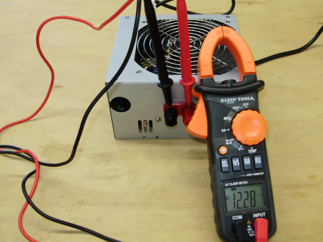

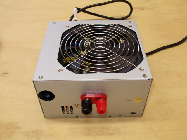

Testing
Now it’s time to see if the supply operates properly. Replace the cover, plug in the 110v power cord and turn on the switch. The fan should start; some have a delay of as much as a second. Be careful not to touch the case at the location where the resistors are mounted it can get quite warm in this area. Now check the voltage between the terminal posts. It should read between 12 to 12.5 volts. If the voltage is too low, less resistance is needed this can be accomplished by using a lower value resistor or putting two resistors in parallel. If the voltage is too high, add a resistor in series. See picture below on how the sample supply worked out!
Note: I later found a plastic knock out plug to fill the hole left in the case by the original wires and also located some stick on rubber feet for the power supply.
