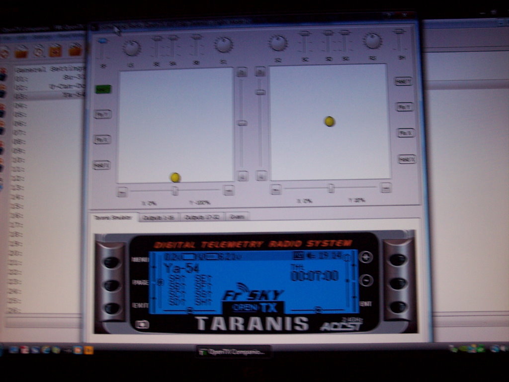

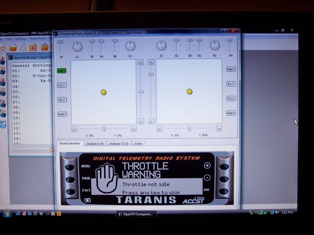

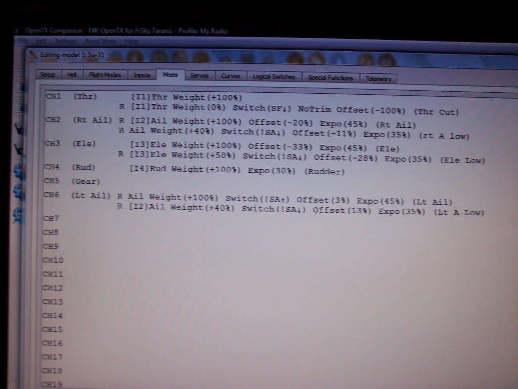

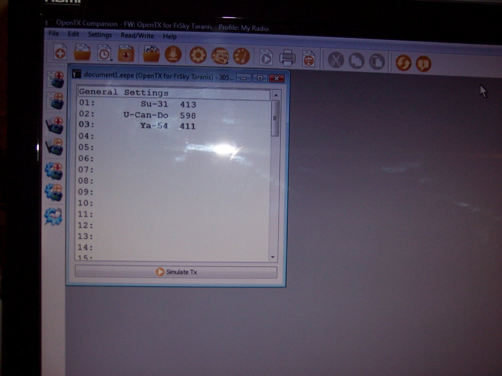

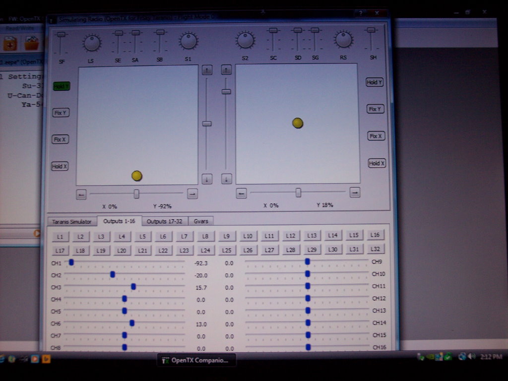

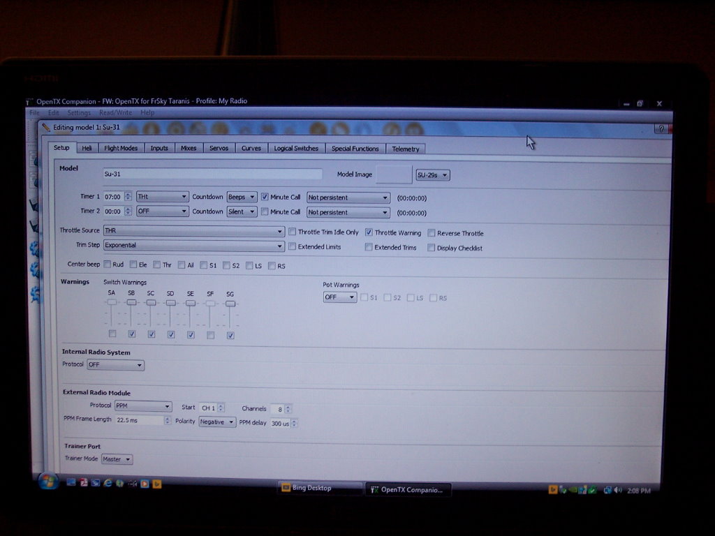

Well I finally got three airplanes programed into the Taranis. I have tested two of them in the air and they worked great. The more I play with the radio the easier it is, and more I like it. I have got the basics down pretty good. It took me two days to program the first one and 15 min. to do the last on. It can be programed on the computer using “Open TX Companion”. Here is some pictures of the program screens.[Not very good pictures]
