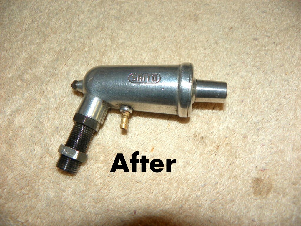

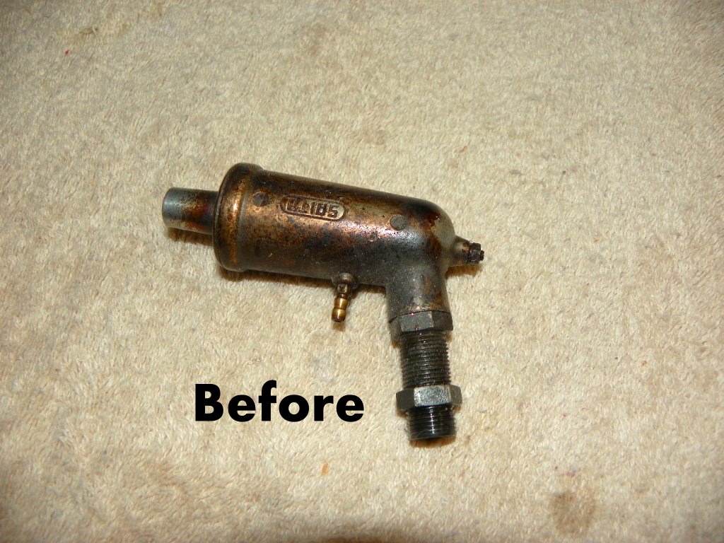

Here's a worst case I had. A muffler with years of burned on oil. It took three soakings and some SOS, but I got it done without damage to the muffler.
						Re: Dirty Engines and Mufflers
Alot less equipment and probably faster
